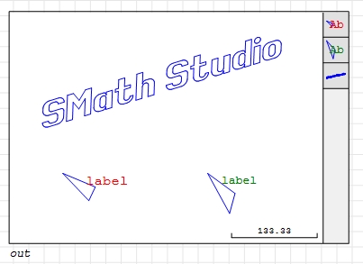

Hello, please someone knows how to rotate text in modeller region?
#64 Posted: 8/7/2021 6:26:59 PM
Hi. This is a workaround, based on https://en.smath.com/forum/yaf_postst20332_Drawing-Text.aspx
DrawingTextModeller.pdf (104.58 KiB) downloaded 912 time(s).
DrawingTextModeller.sm (278.08 KiB) downloaded 1671 time(s).

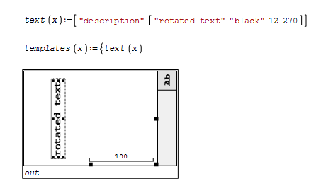

#66 Posted: 8/10/2021 7:59:32 AM
1,443 likes in 2,935 posts.
Use 270 as 4th argument to rotate 90° counter-clockwise

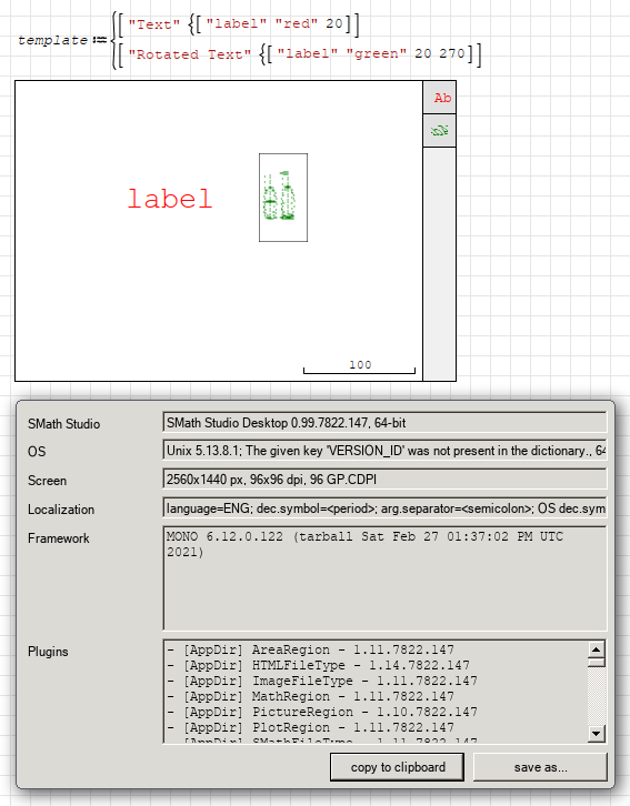

#67 Posted: 8/10/2021 12:54:54 PM
598 likes in 1,380 posts.
Text Rotation in modeller region with 270 as fourth argument is not working under Linux.
I had encountered this several months ago, maybe years. Forgot to report it.

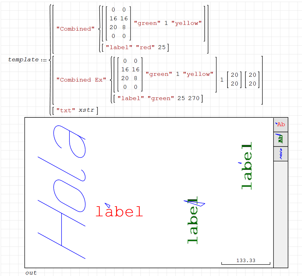

#69 Posted: 8/11/2021 10:56:20 AM
Thanks Davide for rotated text in Modeler.
modeller Rotate Text.sm (177.71 KiB) downloaded 1696 time(s).
#70 Posted: 8/12/2021 2:53:06 PM
I'll look into it, thank you.
This is how it is rendered with rotated text.
