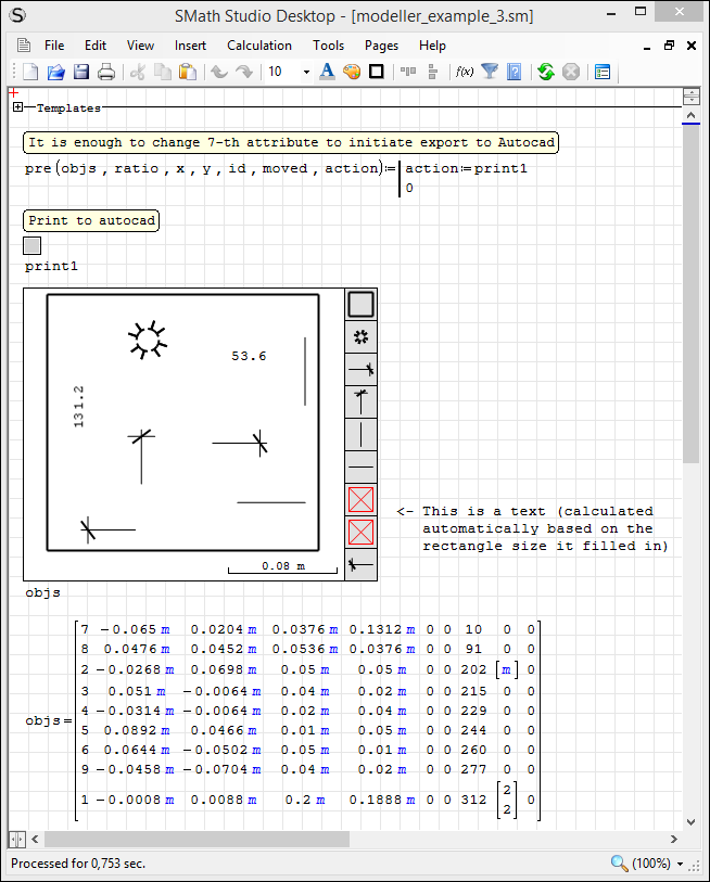

- Create a palette item "node" (maybe like the hinge in the beam FEA example)
- Interactively drag as many node objects from the palette to the positions where you want the nodes to be. You can drag around them afterwards or delete them using the del key.
- The new co-ordinates are reflected in the output matrix.
There is some sort of snap but I didn't manage to understand it.
The canvas objects have a context menu, where you can enter exact co-ordinates and dimensions.

The beam FEA example shows most of what I know about the modeller region.
- how to set up a palette
- how to initialize the model
- how to process interactive changes
I evaluate the position and the size of the canvas objects as input for the calculations (magnitude of loads, thickness of beams). Best is to play around and see how the output matrix changes.
Have a look at Andrey's examples (e.g. rainbow game). there is much more possible than I have used.

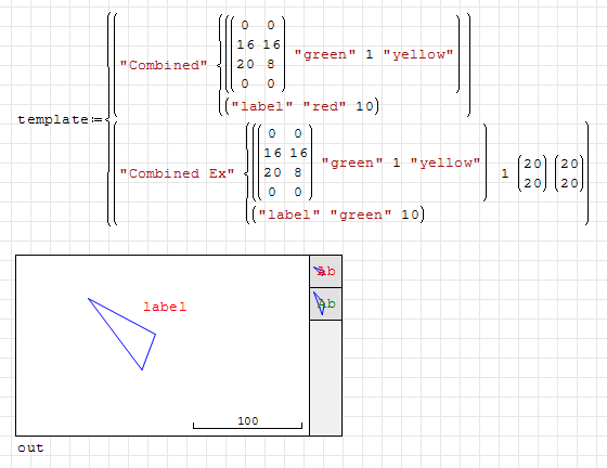

WroteIs it possible to create an object that combines text and geometry (say crosshair of a node with text value "1" ?
It is possible, using a system to group the items, but you loose the fill color property for polygons... The text is anchored to the top-center marker, the polygon bounds are related to the text size (a little bit tricky to manage)
![2016-03-14 11_09_06-SMath Studio Desktop - [Documento1_].png](/en-US/files/Download/avqsur/2016-03-14-11_09_06-SMath-Studio-Desktop---[Documento1_].png)
mod.sm (4.86 KiB) downloaded 1591 time(s).

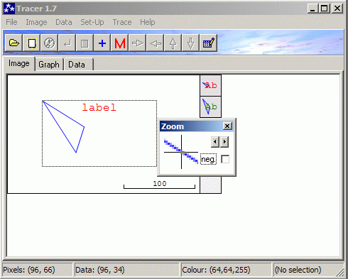

I didn't know how to use Modeller. It opens in 5346
and plots the dotted rectangle. Gorgeous little tool.
The attached *.gif is just pasted by default. Mostly
used for capturing data points from crappy graphs.
It has the option to define the 4 corners in terms of
pixels and values for true XY plots. It was freeware
from Markus Karolweski, but don't know if still in
the web. A stand alone *.exe tool.
Any one interested, easy to attach. No restriction
to redistribute as is.
