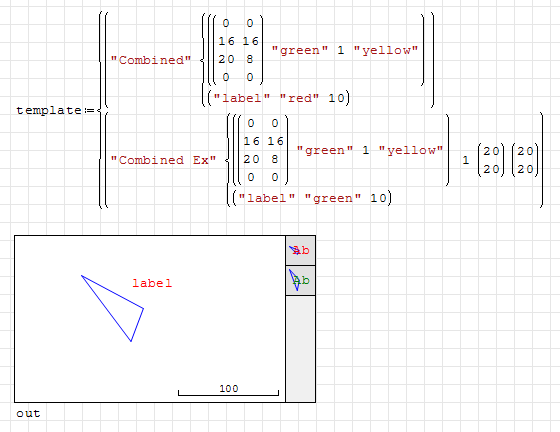

#31 Опубликовано: 14.03.2016 07:21:02
Is it possible to create an object that combines text and geometry (say crosshair of a node with text value "1" ?
It is possible, using a system to group the items, but you loose the fill color property for polygons... The text is anchored to the top-center marker, the polygon bounds are related to the text size (a little bit tricky to manage)
mod.sm (4,86 КиБ) скачан 1600 раз(а).

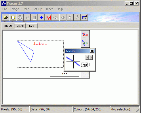

Thanks Davide,
I didn't know how to use Modeller. It opens in 5346
and plots the dotted rectangle. Gorgeous little tool.
The attached *.gif is just pasted by default. Mostly
used for capturing data points from crappy graphs.
It has the option to define the 4 corners in terms of
pixels and values for true XY plots. It was freeware
from Markus Karolweski, but don't know if still in
the web. A stand alone *.exe tool.
Any one interested, easy to attach. No restriction
to redistribute as is.

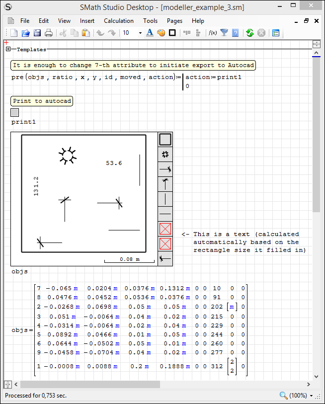

Error related to Shapes content based on its size in Modeller was fixed, so I want to share a sample which shows:
  • Several simple Shapes;
  • Auto-calculated horizontal and vertical text (value based on Shape size);
  • Exporting to Autocad.
P.S.: For now it will work in latest nightly build only.
frapuano 30.05.2016 01:58:00, Davide Carpi 30.05.2016 04:51:00, Alexander O. Melnik 31.05.2016 11:11:00, Ernesto 30.05.2016 01:02:00
