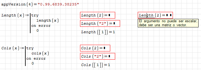

Hi. There are not try-catch here.

#3 Posted: 10/6/2018 9:21:26 AM
Alvaro Diaz Falconi
Alvaro Diaz Falconi
992 likes in 1675 posts.
This seems to be a workaround for the bug.
Length_Try_Catch.sm (8 KiB) downloaded 66 time(s).

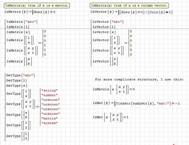

With this version of IsMatrix you catch the length for symbolic matrices. Also, avoiding the use of strings have some advantages over the simple version, here as IsMat.
Length.sm (48 KiB) downloaded 78 time(s).

Described behavior of the try...catch is by design.
In your example length(x) calculated symbolically and does not raise an error. You can check it by calculating length(x) with symbolic optimization.
To have the behavior you want please use eval(lenght(x)) instead.

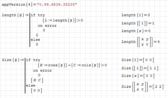

Hi Andrey. Thanks for the clarification. I guess that the origin of this behavior is from about which is the "default unassigned variable type" in SMath. In maple and mathcad it is a complex number, but in SMath it seems to be a matrix or anything else:
If this is the case, it's correct to return rows, cols and length as an error in numerical evaluations and unevaluated form in symbolic ones.
For other side, it seems that if actuate like having something like evalb (maple's eval boolean), forcing the numerical evaluation, as it is showed in the yellow regions, and widely apply in the attached. This behavior is very useful, at least to me, because enable following routines for Length, Rows, Cols, IsMatrix (without using num2str which causes some issues for some applications) and others useful tools, which yield the same result for numeric and symbolic evaluations, making more easy the live to me.
Unassigned variables are considered as unknown type; there were problems in the past because they were consider scalar or matrices...
I suggest to open a separate correction request here or in the bug tracker to improve behavior of length/rows/cols when a matrix contains unknowns...
