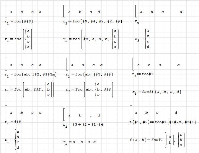

#183 Posted: 11/13/2024 3:47:53 AM
1403 likes in 1708 posts.
SMath Studio compatibility
Plugin updated.
Changes:
- fixed image handling functions (READRGB(),...);
- the appearance of brackets has been changed;
- added the ability to explicitly specify an insert for MathcadBlock (##, #1, #2, ...).
mathcadblock-explicit-paste.sm (15 KiB) downloaded 95 time(s).

#184 Posted: 11/13/2024 4:42:40 PM

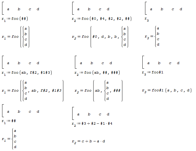

Expanding the idea of ​​numbering, we can add syntax:
## - take all as sys|mat|line
#i#j - take from i to j
##j - take from 1 to j
#i# - take from i to end
and
#i#js - sys(#i,..,#j)
#i#jm - mat(#i,..,#j)
#i#jl - line(#i,..,#j)
#i#jfun - fun(#i,..,#j)
or
### - insert as parameters: foo(x,y,###) -> foo(x,y,#1,#2,...)
##3# - insert as parameters: foo(x,y,##3#) -> foo(x,y,#1,#2,#3)

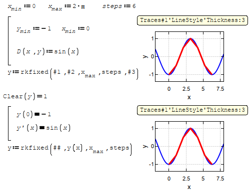

#185 Posted: 11/13/2024 11:20:14 PM
1225 likes in 2151 posts.

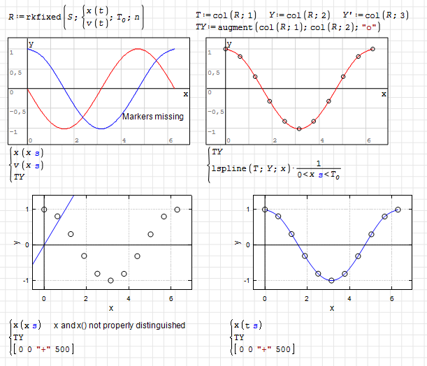

I encountered a plot problem with the list version of rkfixed(). Probably this also applies to other ODE-integrators with embedded function assignment.
In the native 2D Plot:
- When plotting a solution function along with a matrix of marker points, then the points won't display
- Yet, when using lspline() directly, both objects plot without problems.
In X-Y Plot:
- When the independent variable has the same name as the solution function (e.g. x(x), then x() is not treated as a function but as the expression x (similar with v(v) or any other name).
- A workaround is to use a variable name different from the function name. Yet this is strange, because in SMath x() and x usually are independent objects.
plotproblem.sm (30 KiB) downloaded 80 time(s).
Вячеслав Мезенцев 11/13/2024 11:47:00 PM

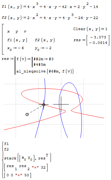

#188 Posted: 11/15/2024 5:14:39 AM
mathcadblock-alnleqsolve.sm (12 KiB) downloaded 92 time(s).
Alvaro Diaz Falconi 11/16/2024 8:51:00 AM

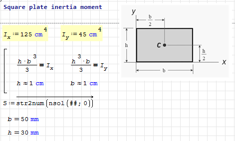

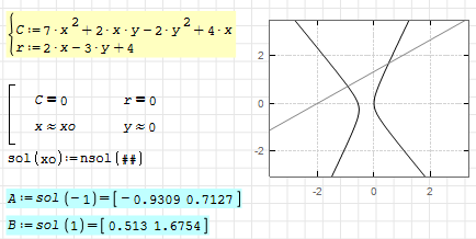

#192 Posted: 12/13/2024 8:06:09 PM
I'd like to have such things like nsol in SMath core.
How about embedded assignment, similar to FindRoot? I don't like poking the values out of S. I see that this might reduce flexibility, e.g. in the case of parametrized initial guess.
I tried to demonstrate a generic approach, i.e. you get the variables assigned without having to issue any specific command except for the generic content of the placeholder. It is just a try and fails with single variables but you get the idea.
Of course, one would like to have a solve block without the cryptic generic expression in the placeholder.
Perhaps, such a block could be created from the insert menu with pre-allocated content of the placeholder and with setting it to hidden.
BasicHandbook-nsol_Kr.sm (333 KiB) downloaded 76 time(s).
Alvaro Diaz Falconi 12/13/2024 10:00:00 PM
#193 Posted: 12/13/2024 10:21:36 PM
Alvaro Diaz Falconi
Alvaro Diaz Falconi
992 likes in 1675 posts.
Hi Martin. I put "0" as argument because there are no more args. The second could be a vector of options, like this:
or the solved variables. Also, I use "S" because this error, which I imagine that could be corrected, but don't know how hard it could be:
PD: Notice that x# : transpose(str2num(x#))*diag(U#) or x# : diag(U#)*str2num(x#) if you want to return the answer as column vector, like normal people, returns x# as scalar if length(x#) = 1.

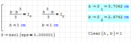

#194 Posted: 12/14/2024 7:36:10 AM
Alvaro Diaz Falconi
Alvaro Diaz Falconi
... How about embedded assignment, similar to FindRoot? I don't like poking the values out of S. I see that this might reduce flexibility, e.g. in the case of parametrized initial guess
Hi Martin. I think the opposite: the implicit assignment of the names of the variables sought to a solution makes its call very rigid, since many times there is no direct relationship between the variables of the equation and the names of the variables that are intended to be assigned to the solution, as is precisely demonstrated in this case
Another variant among many would be to find a limiting speed and call the result v.lim, even though the variable of the equation is "v".
