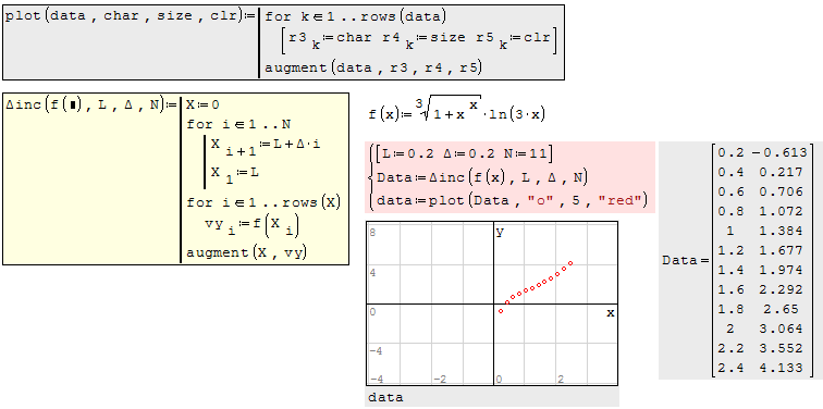

#4 Posted: 3/13/2020 5:30:47 PM
I'm doing something wrong, or it's a bug? Thanks!
Some examples ...
Utilities Pts Critical Monte-Carlo.sm (18.33 KiB) downloaded 1161 time(s).
Utilities Program While FindIndex.sm (34.87 KiB) downloaded 1142 time(s).

#6 Posted: 3/13/2020 8:38:39 PM
I'm not sure I understood how to solve my function by this examples.
Your proposal is not a case of while loop,
strictly wrong application.
Page44 Unknown.sm (73.22 KiB) downloaded 1359 time(s).

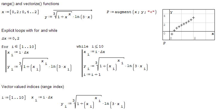

#7 Posted: 3/14/2020 6:06:47 AM
You can do the job using a while loop but it is just one option (perhaps not the most straightforward one).
loops.sm (10 KiB) downloaded 1167 time(s).

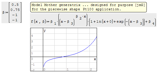

#12 Posted: 3/14/2020 10:11:42 AM
Pascal is pretty retarded these days for Engineering applications !
Years ago, Mathcad for Universities was pretty freaked.
Better use Smath productive for studies & Engineering.
Golden ratio will be a life time productive Companion.
As well as an advanced WhileLoop.
Golden Ratio jmG.sm (39.41 KiB) downloaded 1138 time(s).

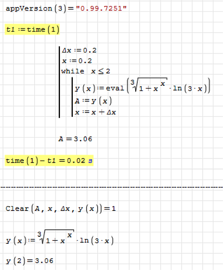

#13 Posted: 3/14/2020 11:20:50 AM
so is it possible to check this function with while loop, or no?
Absolutely, and there are several ways.
If you need a step-by step feedback on the fly you can use breakpoints (menu of math regions) and the debugger window ("View" menu). You might have to store the intermediate results in a dedicated variable though, to don't look into the whole matrix at each step.
Also you can use the function trace() and the output window, or you can build math strings using concat() and other functions, or maybe something more complex using the script region plugin by uni.
loops-1.sm (30.01 KiB) downloaded 1087 time(s).
