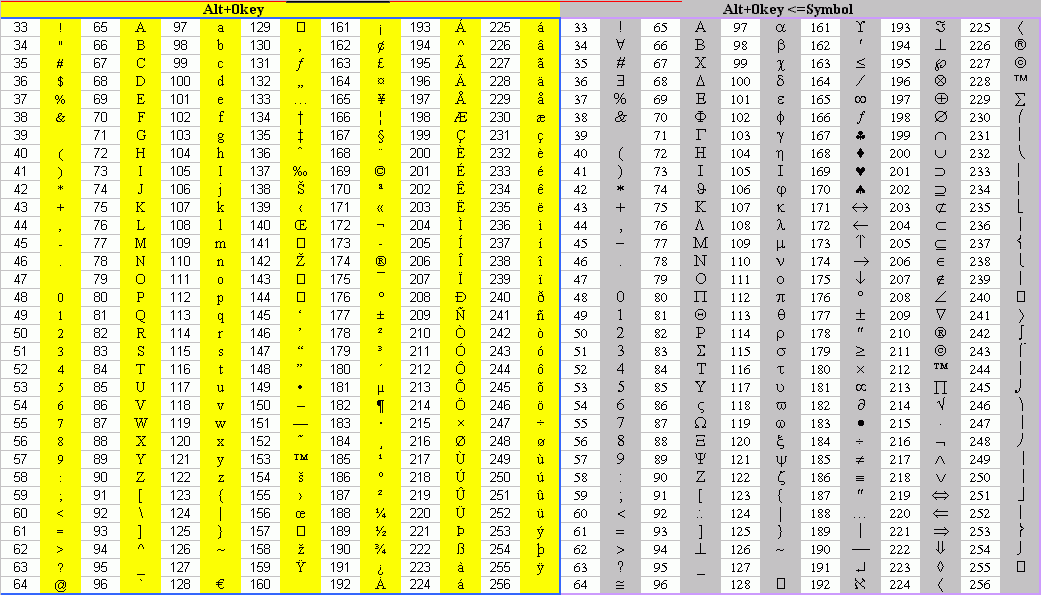

I confirm... it's not the absolute value, but the assignment ":" (sequence to reproduce the issue: ~ -> f -> ( -> x -> "->" -> : )
the ~ can be obtained by typing "Alt" + 0126 (from numpad)
