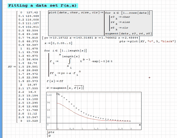

#1 Posted: 10/10/2018 2:17:13 PM
γ(a,x), Γ(a,x) ... read the document...
... mostly used in fitting data sets.
Γ(x) 15 Decimals [Abramowitz & Stegun].
Maths Special Gamma(a,x) Incomplete Quick Copy.sm (67.27 KiB) downloaded 1282 time(s).

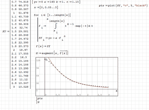

#2 Posted: 10/11/2018 1:45:41 PM
Hello Jean
A few small changes in the part that is shown.
Maths Special Gamma(a,x)_Quick Copy_R1.sm (71.39 KiB) downloaded 1251 time(s).
Carlos
Carlos
#3 Posted: 10/12/2018 1:49:40 PM
Playing a little test and error with the
coefficient y0, a, b, and n,
you get a better fit in the curve.
Maths Special Gamma(a,x)_Quick Copy_R2.sm (68 KiB) downloaded 1248 time(s).
Carlos
Carlos
#4 Posted: 10/13/2018 4:24:36 PM
WrotePlaying a little test and error with the
Thanks Carlos.
Here is an even better fit from your data reduction method.
Data reduction was introduced in the Mathcad DAEP [2003].
Kiby2 is stricking of realism ... attached.
More was done: linearisation of T/C [Thermocouple]
Genfit 000Carlos.sm (42.82 KiB) downloaded 1216 time(s).
Genfit Kirby_2 [Reduced].sm (75.33 KiB) downloaded 984 time(s).
