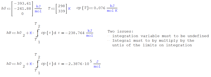

Hi. Try this:

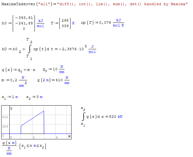

#6 Posted: 4/1/2019 8:22:41 PM
Maxima can handle integrals with units. Yet the restriction applies that the integration variable must be undefined.
int_issue_Kr_units.sm (10.14 KiB) downloaded 1119 time(s).

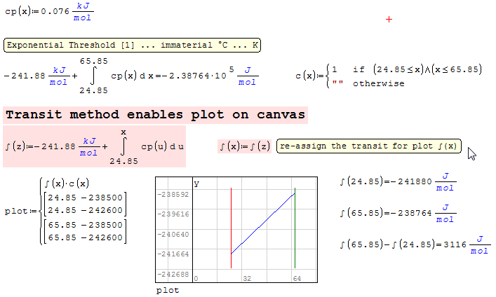

#7 Posted: 4/1/2019 10:49:00 PM
Native Smath does it in much greater elegance.
int_issue [Transit Method].sm (9.39 KiB) downloaded 904 time(s).

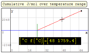

#8 Posted: 4/2/2019 9:14:40 AM
Refreshed version managed from annoying units
Integral 0000000 Transit-Units.sm (23.78 KiB) downloaded 1135 time(s).
