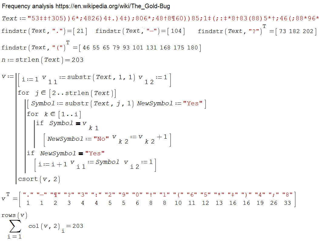

#1 Posted: 10/19/2023 5:44:00 PM
Valery Ochkov
Valery Ochkov
55 likes in 633 posts.
Gold-Bug.sm (80 KiB) downloaded 79 time(s).
#2 Posted: 10/19/2023 6:56:08 PM
Gerry_Bush
Gerry_Bush
12 likes in 14 posts.
One issue is that the if statements should be under separate Line arguments, |.
However, correcting that gives a different output to the example so there may be other issues.
Gold-Bug_updated.sm (81 KiB) downloaded 77 time(s).
Valery Ochkov 10/19/2023 9:30:00 PM
#3 Posted: 10/19/2023 9:11:41 PM
Arie
Arie
93 likes in 285 posts.
What is the text string used in the Mathcad File? I can see in the Text string in SMath that no "]" character exists. So I would not expect to have the same result as the Mathcad screenshot.
#4 Posted: 10/19/2023 9:29:29 PM
Valery Ochkov
Valery Ochkov
Thanks to all!
Gold-Bug.sm (12 KiB) downloaded 70 time(s).
