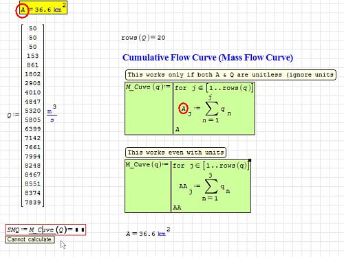

I get an error when using the same variable name in worksheet and inside the program loop.
Why do I get this?
In many earlier SS versions (can't remember versions) it worked perfect

#2 Posted: 4/14/2018 8:51:03 AM
look here
frapuano 4/14/2018 10:26:00 AM

Thanks Davide. I got it.
#4 Posted: 4/14/2018 10:45:49 AM
... added the note wrt scalar Σ
Assignment Error with Units in Program Loop[1].sm (15.84 KiB) downloaded 928 time(s).

Thanks Jean for the useful tips.
