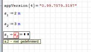

#12 Posted: 10/12/2020 3:31:13 PM
Jan Claeys
Jan Claeys
2 likes in 25 posts.
Dear all,
Thank you for the feedback!
@Andrey: thank you! I hope you can trace the concerned background process successfully. FYI: I use the most recent Windows incarnation (Windows 10 Pro; build 19041.508)
@Jean: it's a bug without any doubt (although not always repeatable), please see the screenshot below
Kind regards,
Jan

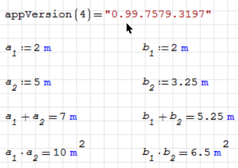

#14 Posted: 10/12/2020 11:37:05 PM
Hi. I can't reproduce the bug, but it could be interesting to know if, in the case you have the error, if you can see the tooltip about the variable value, as in the image. Isolated or when you write it into an expression. Obviously, autocalculation must to be on.
