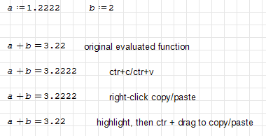

As the title says, this is a question about the decimal places when using the copy/paste function within SMath. (ctr+c,ctr+v)
Once the formulas are pasted in place, they default to 4 decimal places.
This isn't that big of a deal, but it is rather annoying to have to go back and reset the decimal places to the desired number. This is especially annoying when you have results shown to different decimal places.
Keep in mind my default is set to 2 decimal places. So when I paste some formulas (even from the same worksheet), they will appear with 4 decimal places.

you may have missed my point here. Even though I have the default set to 2 decimal places (which works as it should when I manually enter a formula), when I copy that same formula using ctr+c and paste using ctr+v, the result will display with 4 decimal places if the decimals are available in the formula.
so 1.2222 + 2 = 3.22, but when I copy and paste this, it looks like 1.2222 + 2 = 3.2222

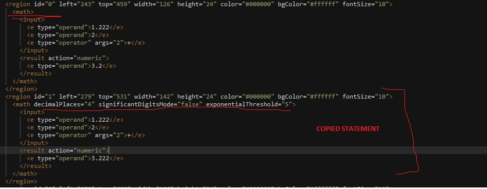

If you copy the expression (operators & operands only) leaving out the evaluation "=", then paste and hit "=" it copies properly.
i.e., Copy and paste "1.2222 + 2" then press "=" instead of copying and pasting "1.2222 + 2 = 3.22"
The problem seems to stem from the fact that each statement can deviate from the default number of decimal places. For some reason when you copy an evaluation it seems to take on the number of decimal places as the highest operand. But if you add the evaluation after the paste, it works properly.

For the devs....
It does look like when the evaluation operand is copied, the math region has some deviations from default compared to the region that it is copied from. Is this intended or for any specific purpose?

Are you talking about right-click copy/paste? That produces the same result as ctr+c/ctr+v.
Interestingly enough though, if you copy/paste by holding ctr, then clicking and dragging, it copies the evaluated function and keeps the original decimal places.

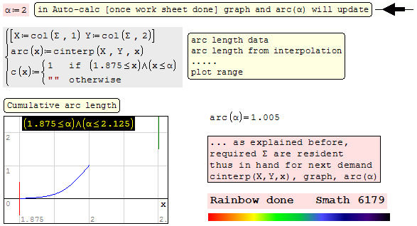

"this feature is genius" Jean, can you elaborate on what exactly "this feature" is?
Differently than Mathcad/Mathsoft [because Mathcad/PTC does not exist for me]
that re-calculates the entire document when opening, because it strictly scalar,
Smath stores all calculated values as vector element [single, data set ...]
then when opening an Smath document you don't have to "Calculate Work sheet"
for what has already been calculated and stored. Very handy in many instances.
The keyboard copy/paste dates back Win 3.1 ?
Cheers ... Enjoy Smath
#10 Posted: 8/16/2019 6:14:08 PM
983 likes in 6866 posts.
As you download this document, you have to "Calculate Work Sheet".
Naturally because it does not reside in your machine.
Once calculated [6 min in my machine] save/close.
Re-open don't re-calculate and see the 'data' page 3/4 table is now existing.
You can copy/paste the resident 'data' in blank work sheet
OK, Mathcad would calculate in few seconds.
Integral COMPANION Adaptive Romberg-Simpson(f,a,b,n).sm (104 KiB) downloaded 63 time(s).
