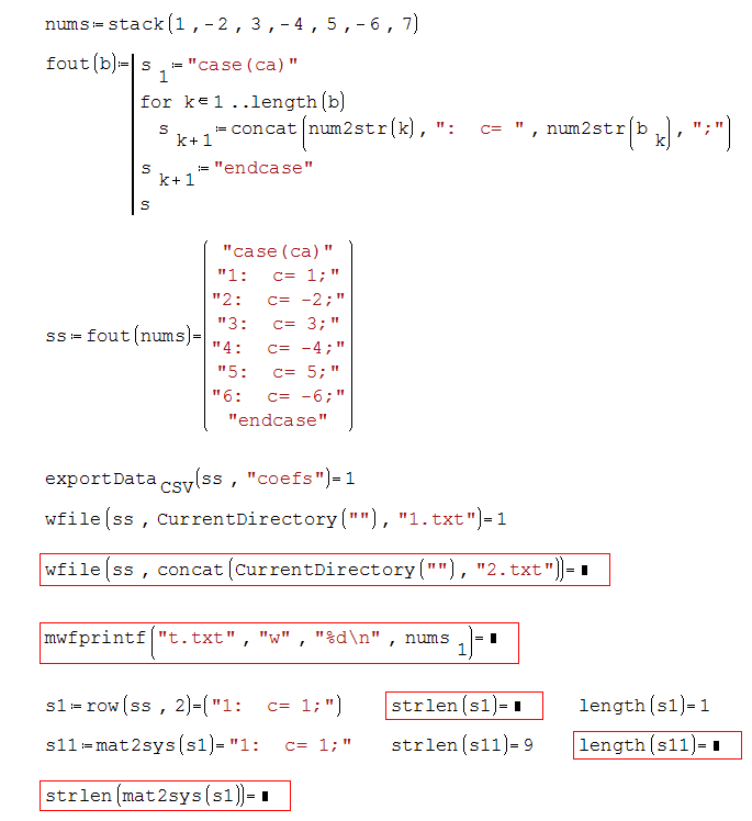

Recently, I tried to use Smath to generate simple Verilog code, just a case statement.
First, I created a vector/matrix where each component is a string.
Than I tried to write this structure to the text file. Unfortunately, I haven't find
proper way to do this simple thing. I always saw "" around the strings written to the file.
mwfprintf - doesn't work at all, wfile(2) doesn't work as well, wfile(3) surprisingly works !
Of course, it is a problem of the plugin writers, but ... frustrating.
Next attempt was done to disassemble the matrix using row() function, it worked,
but the type of the created object was not string.
Than I tried to convert it to string using mat2sys(), it also worked, after that I can use strlen(),
it returns valid number of characters. But if I nest the operations, strlen(mat2sys()) fails.
It might be a good idea to sort out this small issues. It, it's confusing now.

Hello tomtit
I think that the problem is that there's not yet the function that you need... A dirty way could be to export the data to a spreadsheet and then copy and paste all in a text file.
I think that another function to fit your purposes could be easily added in my DataExchang plugin; I accept any suggestion about the input syntax (vector,matrix,system) and the desired output.
F.E. I can imagine a exportData.CODE or something similar where you can add a vector of strings with special flags like {\t} {\q}... to write tabs, quotes...
About the issues:
wfile() is provided to export the data as SMath plain text; the second argument must be a unknown (is not handly, I admit) and the ouput file will be placed in the "%APPDATA%/SMath/user" folder
exportData.CSV() is provided to export mixed data as a CSV file in the most compatible way; because strings may contains commas, or the target program may trim leading/trailing spaces, so any string is quoted.
strlen() measures strings, not matrices or vectors
length() measures matrices/vectors, not strings
row(), mat2sys() are not the right way, use an el(SS,2) instead; row() returns a row vector, a list (or system) of one element hide the system by default but is very error-prone (the value is yet a system if you use the symbolic optimization)
best regards,
Davide

#3 Posted: 2/27/2014 11:33:39 AM
Hi Davide,
Thanks a lot for detailed explanation, but there is some misunderstanding of the purpose of my last post.
I do know how to do things right, it was just a way to show that
s11:=mat2sys(s1) followed by strlen(s11) is not equal to strlen(mat2sys(s1)).That is certainly a bug.
Anyway, the suggestion is to implement a function WhatIsTypeOf(expr), returning a string, containing the type of the expr.
It may help a lot in debugging difficult to understand issues of automatic type conversions.
Best regards,
Igor
P.S. Davide, I desperately need an extension to you DataExchang plugin with a functionality of good old fprintf(file,format,par1,..,parn),
or at least just fputs(string, file).

#4 Posted: 2/27/2014 12:14:00 PM
mwfprint() not finished. This function works only with numerical matrices not with strings. Simple example can be found here.
wfile(3) and rfile(2) - are the part of Mathcad File Access plugin. They do the same things (like wfile(2) and rfile(1) ), but you can work with any path as you wish.

#7 Posted: 2/27/2014 8:29:49 PM
A fast solution: you can try fwrite(string,filename) or fwrite(vector/system,filename) from the updated DataExchange.
The function overwrite the file at each call so use a matrix like in your example to write the entire script and then call this function.
{\t}, {\n} and {\q} are special flags to add tabs, new lines and double quotes.
You are right about this behavior, I've missed this point...
As I've written SMath has a special feature that converts the system into a simple variable if the system contains only one element; seems this feature is applied after the evaluation, so what is evaluated is always strlen(sys("something",1,1));
I'll try to fix this special case with attention to the optimization, to avoid losses of the sys() features.
