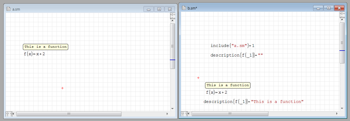

#92 Posted: 4/14/2016 2:32:29 PM
Arie
Arie
94 likes in 285 posts.
Is it possible for descriptions to be passed with include()?
See example
Mike Kaganski 4/14/2016 11:47:00 PM
#93 Posted: 4/15/2016 2:07:43 AM
1,555 likes in 1,867 posts.
No, now this is impossible. Function (AddDefinition() from SMath core lib ) which does the main job dosn't know about the description field for the definition. So I can't add this data.
#94 Posted: 4/15/2016 2:16:00 AM

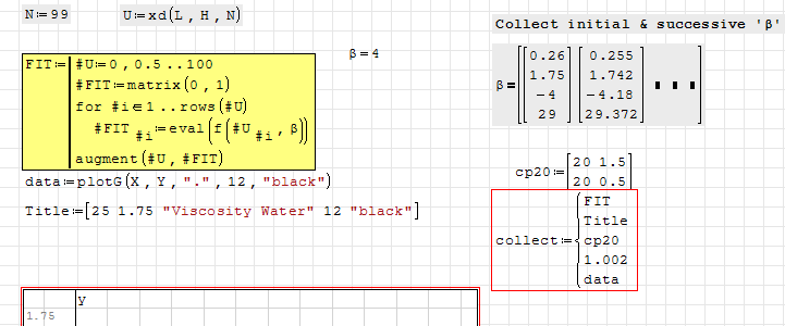

#97 Posted: 4/15/2016 9:35:35 AM
Ruben Sidranski
Ruben Sidranski
17 likes in 465 posts.
Using Jean's files in the same directory, I updated to Mike's sheet and compared it to UNI's pdf ... I still have an error in the re-definition of BETA. Using latest SMath and plugins. BETA.PNG
#98 Posted: 4/15/2016 1:35:38 PM
Thanks Uni, Mike ... works fine. Press = after "Include" to activate.
Elid: try again
#99 Posted: 4/15/2016 2:26:39 PM
Ruben Sidranski
Ruben Sidranski
Jean,
I have the equal sign. It's in Mikes updated sheet. The Beta in the screen shot I took shows 4; whereas Uni's PDF shows a 4x1 matrix (array)
#100 Posted: 4/15/2016 5:45:23 PM
Jean,
I have the equal sign.It's in Mikes updated sheet.The Beta in the screen shot I took shows 4; whereas Uni's PDF shows a 4x1 matrix (array)
You may have to put both work sheets in your Smath working directory.
If you read 4, instead of 1: it does not find the work sheet in question.
If it does not work: the problem is specific to your instalation.
After the wife and the kids, consider re-installing Smath.
