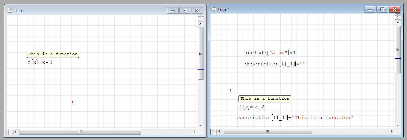

Arie
Arie
Is it possible for descriptions to be passed with include()?
See example
Mike Kaganski 14.04.2016 23:47:00
#93 Опубликовано: 15.04.2016 02:07:43
No, now this is impossible. Function (AddDefinition() from SMath core lib ) which does the main job dosn't know about the description field for the definition. So I can't add this data.
