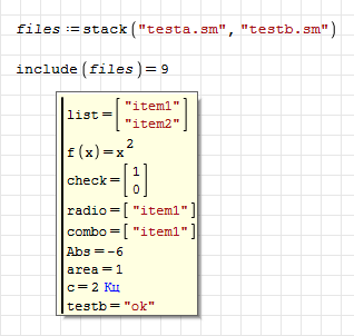

Plugin updated ( ).
Changes:
- restored the possibility of nested call of the include() function;
- added support for list of files.
It is now possible to implement the Reference component.
