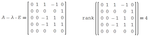

Hallo zusammen,
DimEigenraum: (n-rank(A-λ*E))=1@#
should be 2
some steps of elementary row additions later
is 2
https://de.smath.com/cloud/sheet/vooDFR4FbP
any idea whats wrong?

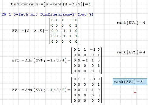

#6 Posted: 4/19/2020 2:09:48 PM
haweHofmann
haweHofmann
3 likes in 32 posts.
rank(M) ... matrix rank is Smath built-in.
Matrix PseudoInverse.sm (111.21 KiB) downloaded 1147 time(s).
and in how far do your example explain the incorrect calculation
The referenced sheet seems to use Maxima(). This doesn't work, as third party plug-ins aren't available in the cloud version.
It is better to attach such files here.
the Maxima part calculate the single eigenvalue which is set manually in cloud version
SMath Studio 0.99.6884 - [JordanMatrix5x5-5fachEW-HV.1.2.Stufe.sm_]_2020-04-19_19-07-08.jpg
JordanMatrix5x5-5fachEW-HV.1.2.Stufe .sm (47.19 KiB) downloaded 1113 time(s).
#7 Posted: 4/19/2020 11:51:44 PM
Hi. You're right, it's a bug and there are no way to make this works (numerical nor symbolic):
First column is zero and 3th = - 4th columns, so can't be rank = 4.

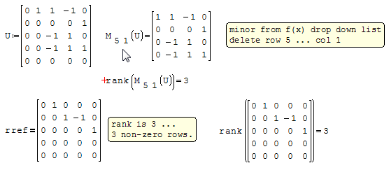

#8 Posted: 4/20/2020 11:51:33 AM
Just advanced maths above the classroom.
Your example replies bug from incorrectly threaded input.
As given, your [5*5] matrix has no mathematical meaning.
Page1 rank.sm (11.74 KiB) downloaded 1278 time(s).
