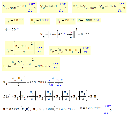

I'm having trouble with solve(), take a look at the example. In one example it seems to work fine, but in another, it does not.
56-working fine
55-not working
Any Ideas?
#2 Posted: 2/6/2023 9:43:27 PM
983 likes in 6866 posts.
Units don't match
#3 Posted: 2/6/2023 10:26:43 PM
... if you zap units, it works.
That suggests to re-introduce units from bottom to top
up to the point it complains for doctoring.
Cheers . Jean.

#5 Posted: 2/6/2023 10:51:12 PM
Wesly Centerwall
Wesly Centerwall
26 likes in 156 posts.
Looks like F was not in lbf/ft. Working now... units included.

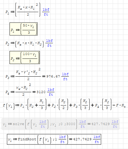

#8 Posted: 2/7/2023 11:15:50 AM
554 likes in 1333 posts.
FindRoot() can work with units and you won't have to enter range.
Just give it a reasonable starting point/guess.
solve() can also be tricked to work with units.
I also showed it in your example.
