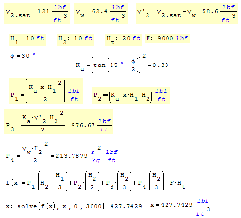

I'm having trouble with solve(), take a look at the example. In one example it seems to work fine, but in another, it does not.
56-working fine
55-not working
Any Ideas?
#2 Опубликовано: 06.02.2023 21:43:27
Units don't match
#3 Опубликовано: 06.02.2023 22:26:43
... if you zap units, it works.

I've tried it without units, still the same result.
By the way, I can't open your file, just crashes every time I try to open it.

Looks like F was not in lbf/ft. Working now... units included.
Soil Mechanics Quiz - 0503055 - Solution.sm (59 КиБ) скачан 70 раз(а).
#6 Опубликовано: 07.02.2023 09:12:40
It's common files don't open.
Yellow, I clicked option ignore Units.
Cheers ... Jean.

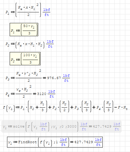

#8 Опубликовано: 07.02.2023 11:15:50
FindRoot() can work with units and you won't have to enter range.
Just give it a reasonable starting point/guess.
solve() can also be tricked to work with units.
I also showed it in your example.
