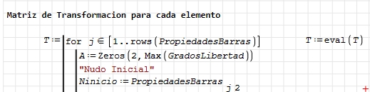

Solve 2D trusses with static loads, temperature changes and node displacements.
Is there a way to improve the speed of the calculations?

Hi. Just add T:eval(T) here

Is there a way to improve the speed of the calculations ?
From 15 min down to 2 seconds
Damned over killed of labels.
