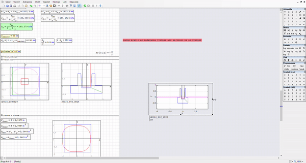

Im gonna explain it graphically
1) on the right you can see stretching of the addon graph
2) on the left you can see fixed XY axis ratio

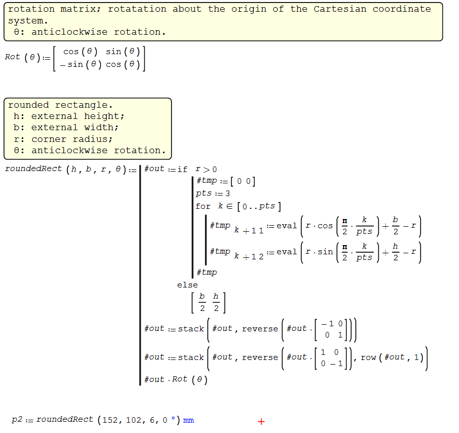

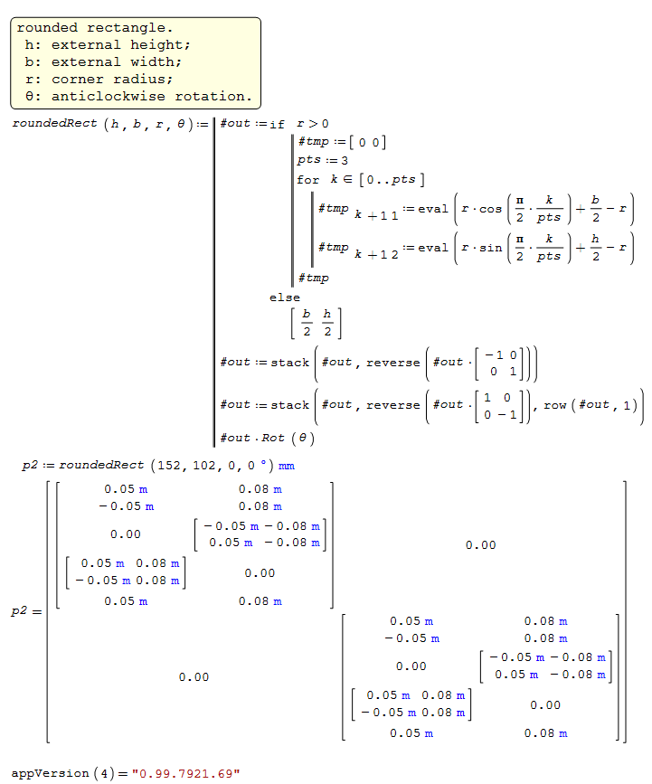

Hi Davide, and thanks for this wonderful sheet.

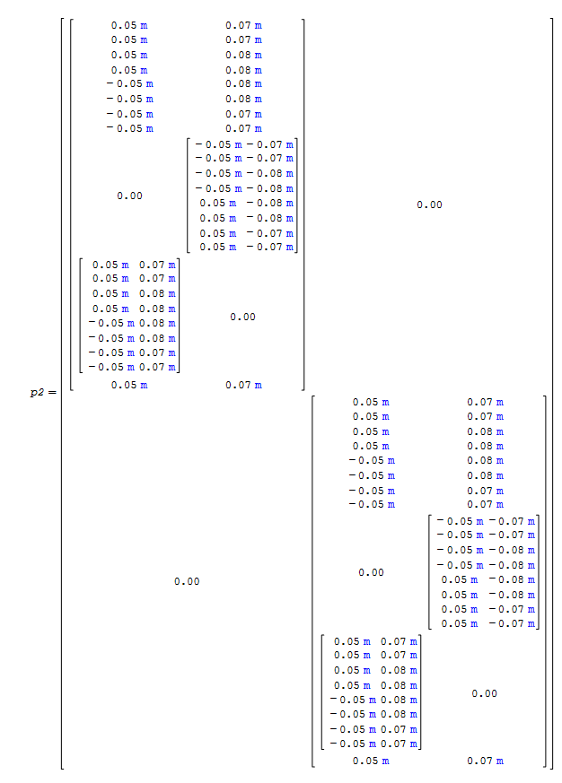

I found a bug in the sheet, for some reason all the rectangle solid or hollow sections don't work. I am using build 7822.
I tried to test your code and for some reason, the compounded matrix created from your shape functions does not end up being a matrix with "n" rows and "2" columns but rather a matrix in a matrix and I don't know why

Mido0,

Thanks Pompelmo, I updated my Smath and still the problem exists!!
Itried to uninstall all Smath and reinstall it again with the same problem!!

Just change p2:roundedRect(...) optimization from symolic to numeric.

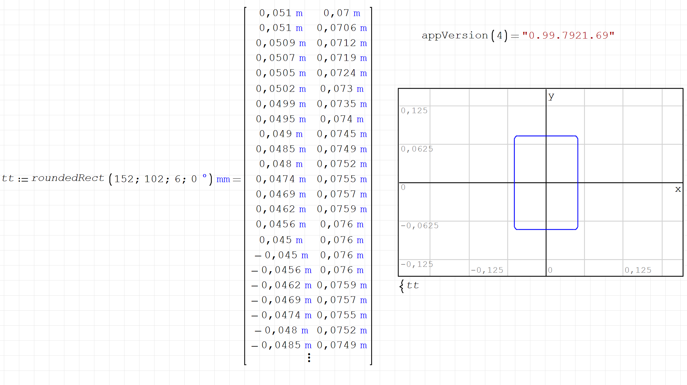

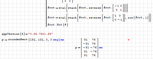

#29 Posted: 1/10/2022 5:39:14 PM
In my personal experience, the stack and agument functions, along with other allies such as reverse and matrix, always manage to cause some kind of issue. The issue also is related about where the evaluation appear, or the function, or something else. The attached shows the issue in an isolated environment.
roundedRect.pdf (124.42 KiB) downloaded 827 time(s).
roundedRect.sm (24.85 KiB) downloaded 1432 time(s).
With those two evals it seems that roundedRect works, for numeric and symbolic evaluations.
