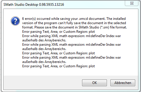

Dear all I'm facing with import problem from Mathcad files, somebody can help me?
The import seems not supporting the plot function and the ceil method
Choke290.xmcd (348 KiB) downloaded 115 time(s).
Here below the error msg I received:
thanks
Riccardo
thanks
Riccardo
#7 Posted: 4/29/2016 11:51:06 AM
The Mathcad "reference" has Smath equivalent "Include".
Your Mathcad 15 is so obsolete anyway !
What about my 1800 Mathcad 11 WS ! I may have converted nearly 100.
Smath is not a 1/1 PTC Mathcad 15. Mathcad 15 was MuPad symbolic abandonned for Maxima.
Smath is Maple symbolic engine, in many instances far superior to Mathcad 11/Maple 11.
It might be wise you purchase a spare PC to install your Mathcad CD, make it work and never
plug to internet connection. You don't know the day PTC will deactivate Mathcad 15 like they
did with Mathcad 11 "Single User Edition" who had purchased or otherwise legally owned.
Just try to save the working Mathcad 15 program, no more gyzma from the work sheet. And if
it works, "pure Smath users" will have to recode in Smath style.
