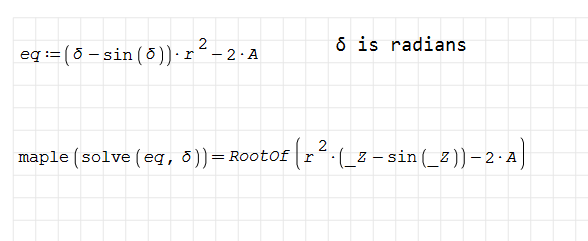

problem01.sm (3.65 KiB) downloaded 1387 time(s).
last time l wrote wrong formular.
how can i solve this formular symbolic?
δ, r, A are all positive.

Your equation may be transcendental. In this case, the solution is written in general form using the RootOf function. This means that a solution has not been found in algebraic form and can only be obtained numerically.
