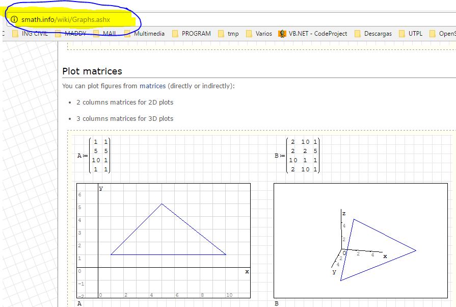

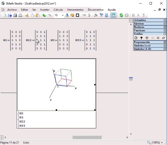

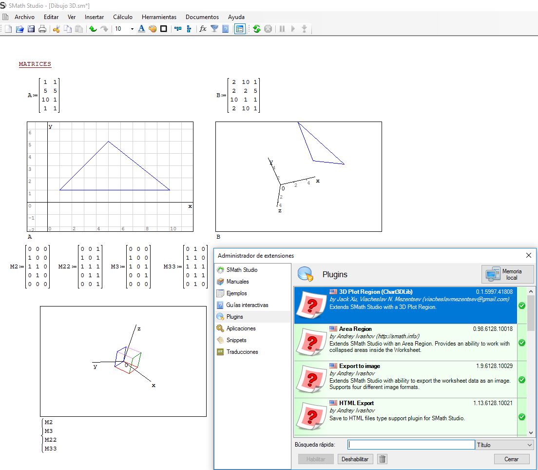

Hi, I am familiar with the Plot3D plugin and I have found that the graphs do not coalesce with the coordinate axes.
Is there any error defining the coordinate matrix?
According to the web help a 3D graphic should be presented as the following ..
Dibujo 3D.sm (81 KiB) downloaded 70 time(s).
When I define it in Smath 0.98 (Build 6128), the result is the following ..
I appreciate comments

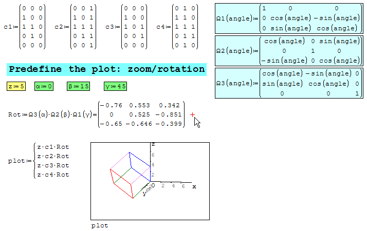

It is possible to apply the method
http://en.smath.info/forum/yaf_postst2215_Transferring-three-dimensional-image-on-a-two-dimensional--flat--graph-by-prof--A-B-Ivanov.aspx
1.sm (18 KiB) downloaded 83 time(s).

Confirmed (but the plugin is Plot Region by Andrey Ivashov, not 3D plot region)
