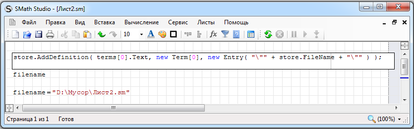

#28 Posted: 9/15/2015 2:37:12 PM
This is as good a place as any:
Is there a function that returns the filename of the current worksheet/Smath Document? I couldn't find it
#29 Posted: 6/7/2017 4:12:30 AM
WroteThis is as good a place as any:
Currently I have the same question and also no answer (and couldn't find one).
Can anybody help?

#31 Posted: 6/7/2017 9:42:05 PM

#33 Posted: 6/8/2017 8:38:18 AM

#34 Posted: 6/8/2017 9:05:42 AM
WroteWroteThis is as good a place as any:
Can anybody help?
As workaround you can use simple C# script for this (Script plugin).
store.AddDefinition( terms[0].Text, new Term[0], new Entry( "\"" + store.FileName + "\"" ) );

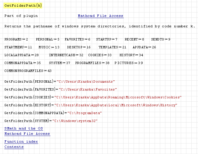

#36 Posted: 10/29/2019 5:05:48 AM
The function getfolderpath() seems to be broken for build 7219:
getfolder.sm (2.21 KiB) downloaded 1693 time(s).
