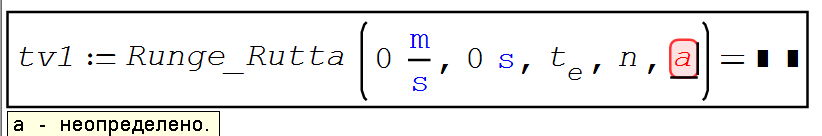

Why I have an error in second sheet?

Runge_Kutta not Runge_Rutta
Also extract t1 and v1 from tv1.

But see please the error message
It's an extremely misleading error message!
