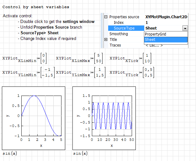

#2 Posted: 12/13/2017 10:33:21 AM
983 likes in 6866 posts.
Is it possible to define XLimMax, XTick, etc on the canvas (outside of the Format dialogue box)?
I thought this was possible but I can't seem to get it to work.
Only Xmin, Xmax [quick]

#4 Posted: 12/13/2017 7:16:29 PM
1226 likes in 2153 posts.
Section 2D plots XY Plot Plugin.sm (91 KiB) downloaded 92 time(s).

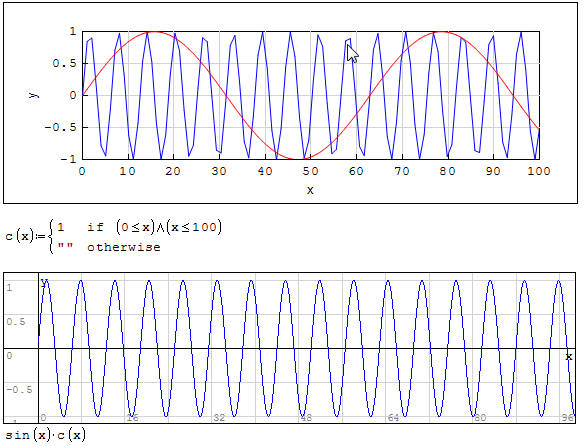

#5 Posted: 12/13/2017 10:54:44 PM
The Smath default quick plot plots values on canvas pixels
i.e: 96 PPI [Pixels Per Inch] ... this is for scalar plot wrt 'x'
X_Y does not understand plotting. To get the fine plot, you must
caliper in PPI the blank plot once stretched. From there, discretize
the ranged function on those number of pixels [scratching the left
ear with the right hand].
