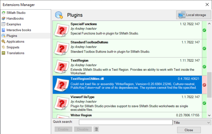

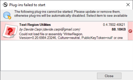

I wished to install TextRegionUtilities but this failed, now I can't enable or disable it from the local Plugins list.
Please help, I don't know the next move.

Hello Davide,
Thank you for lookin at this issue.
WriterRegion is installed. I uninstalled WriterRegion, closed, installed WriterRegion, closed, reopened but unfortunately still get the error.
Tim

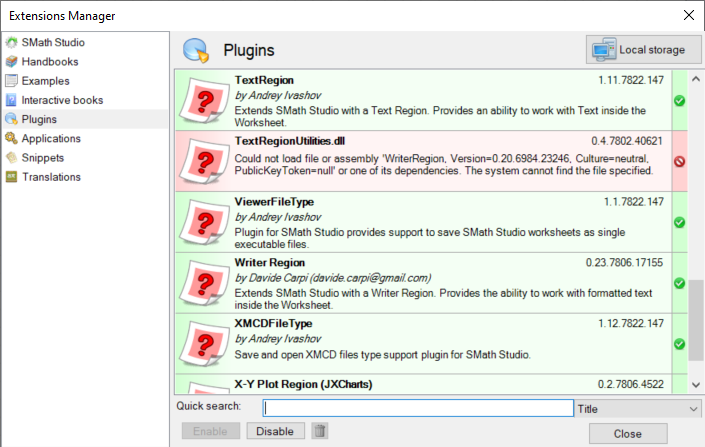

#4 Posted: 10/14/2021 11:14:36 AM
timgow
timgow
0 likes in 27 posts.
Davide,
The enable & disable were greyed out but I didn't realize that the dustbin was active; I deleted and reinstalled, all ok now.
Many thanks,
