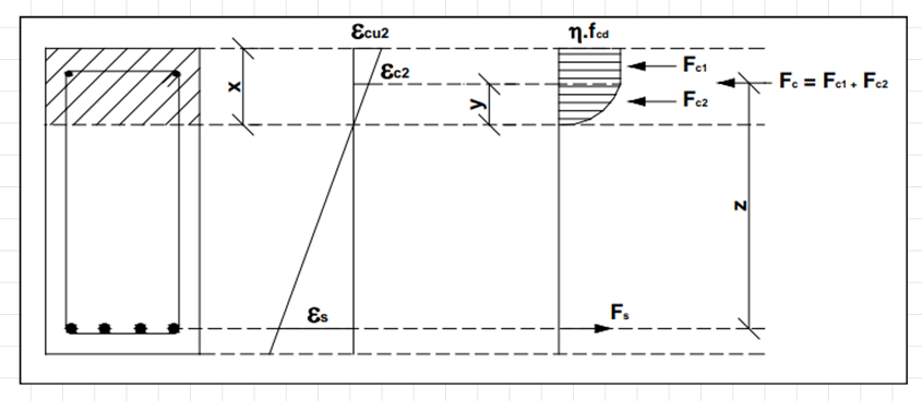

@StvMath:
As you said, you hadn't understood the Joao's problem:
It is a classical reinforced concrete bending resistance for a rectangular section:
![2024-03-18 15_48_08-SMath Solver - [Tentativa de NewtonRaphson_2 (1).sm].png](/en-US/file/rDNdpr/2024-03-18-15_48_08-SMath-Solver---_Tentativa-de-NewtonRaphson_2-_1__sm__png)
With some theoretical and normative assumptions, there is only one unknown "x" and it can be obtained from the bending moments equilibrium equation. All the Joao's development is correct.
The non-linearity of the problem comes from the non-linear behavior of materials.

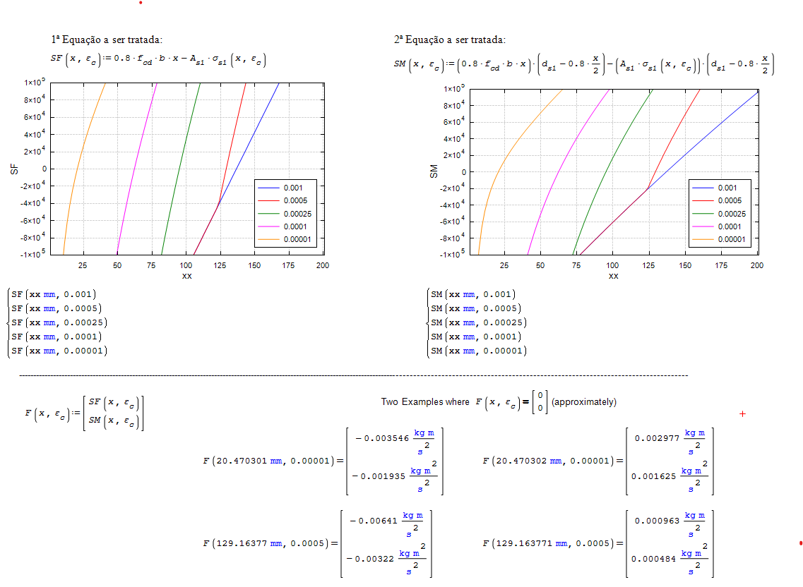

#8 Posted: 4/9/2024 11:51:33 PM
WroteTentativa de NewtonRaphson_3.sm (211 KiB) downloaded 84 time(s).Hello all,
I'm still presented with an "units not matching" error.
The attached now runs (see the comments in red). However, your Newton-Raphson routine diverges. You will need to rethink your logic.
Tentativa de NewtonRaphson_3b.sm (215 KiB) downloaded 92 time(s).
