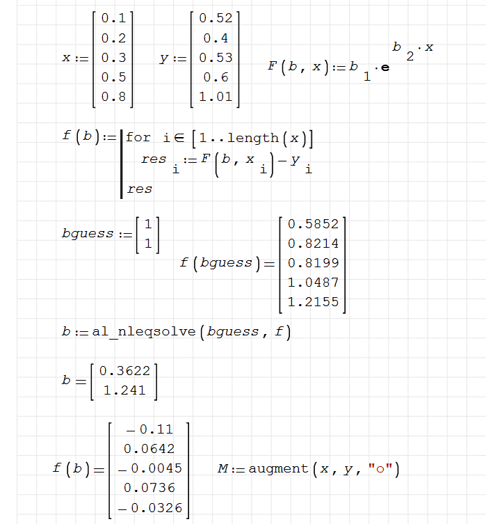

A simple example of curve fitting with al_nleqsolve().
I hope someone will find it useful.
nonlinfit.sm (8 KiB) downloaded 85 time(s).
