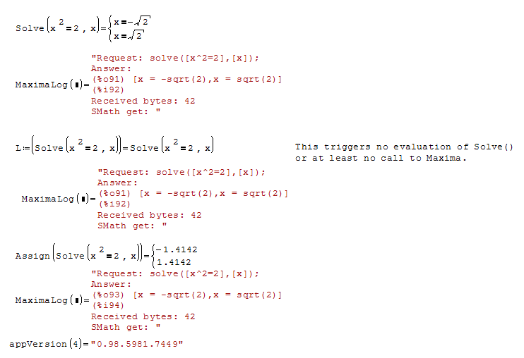

There is a new problem with Solve() from the Maxima plugin. If the function is part of an assignment, then it seems to not be called at all (no increment in the Maxima expression counter in the log).
If it is just evaluated, then it executes correctly.
Also, inside Assign() it works as expected.
SolveProblem.sm (6.23 KiB) downloaded 1645 time(s).
#7 Posted: 5/17/2016 1:53:38 PM
Hello, Martin.
This is due to http://smath.info/bts/Issues/IssueDetail.aspx?id=2318 (details available there).
So, in case of assignment before execution SMath Studio checks if all required variables are defined. And functions at right of definition sign will be called only if this statement is true. Otherwise, all the calls will be postponed till the left side of the definition will be used somewhere (reason is obvious, see the screenshots in SS-2318 ticket).

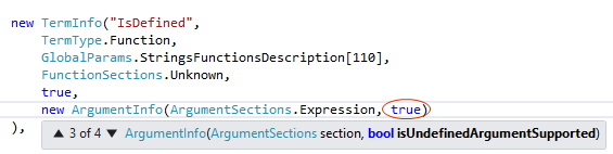

But, there is a possibility to fix this behavior for specific functions in the plug-in: isUndefinedArgumentSupported agr should be set for ArgumentInfo in the plug-in.
Let me know if you still have questions.
Regards.
Regards.
