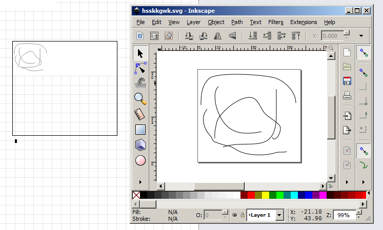

- when the region is emty, the border does not indicate on/off state (yet the setting seems to be stored, image content seems to be required for the border to show up correctly
- Image boundaries in the region and in inkscape don't match. There is spurious whitespace to the right.

3. Image boundaries in the region and in inkscape don't match. There is spurious whitespace to the right. - FIXED
4. Newly created .svg file now scales correctly after being edited in inkscape.
5. when the region is empty, the border does not indicate on/off state (yet the setting seems to be stored, image content seems to be required for the border to show up correctly - Cannot Reproduce, pls attach .sm workbook and explain what is wrong.

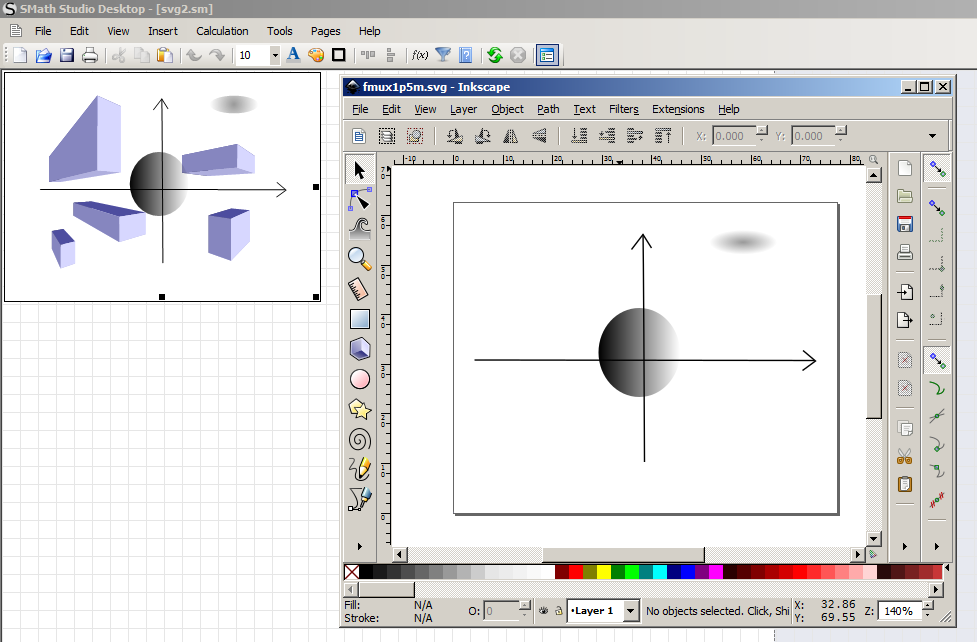

1. Insert> Image
2. try to switch off the image border in the context menu.
this does not work for me, the border is still displayed.
3. If you then create an image (set the format, doubleclick to edit), then the border is removed.
Seems that switching the border state works with an empty region, just the display does not obey the setting.
Another problem:
If I open the image in the attached sm file, then some objects are invisible in inkscape. They all were created with inkscape. The reference points of the 3D projection seem to get lost or modified. Could that be a side effect of the size handling?
svg2.sm (28 KiB) downloaded 1463 time(s).
What is the intent of the different behaviour between cloning and copy/paste? Usually, there is no difference, cloning (ctrl-drag) is just a gui shortcut.
I guess that most users would be surprised by the invisible link between the original and the copy. I'd vote for copy/past behaving just like cloning (same image contents but separate file)svg2.sm (28 KiB) downloaded 1463 time(s).
If multiple instances of the same image are required, then still there is the option to have this as external file (export the file and put the name in the placeholder).

Hi All, I probably wont get to work on the image region till weekend, however it is a good idea to think of a roadmap. Martin, to discuss your comments:
I have done this - found no file found error annoying as well after some use (new .dll is not included yet).
<1. Insert Image
this does not work for me, the border is still displayed.>
Unless I am wrong, this is how original image region behaved (I just redownloaded it), do we want to change that?
I am at the stand still here. The plugin only zooms SVG files if no height/width is present inside the file, or if it is set to % (as I did for blank svg). For either of those cases, when inkscape re-opens the svg, the "3D Box" objects were minimized to the bottom left corner (you still can scale them up if desired). If someone can come up with .svg file that both scales in SMath, and is saved/opened correctly by inkscpe I can use it as a blank document in the plugin. It is not a big deal for me though - how often will you sketch those 3D boxes in SMath?
This one is tricky. While there is no intent, per say, I am not sure how to change it either. You see, I can define Clone () though the code, while copy/paste just takes the region and creates the exact duplicate (just like Davide mentioned). And while you can edit the formula you copy/pasted, you cannot redefine the filename of the image in the region from SMath. Davide, do you think there is a conceptual way to change the name of the imbedded image during copy / paste? I cannot think of one..
Will try :-) update / resize functions are used throughout the code and it will take some effort to seprate the two (i.e. resize without re-rendering of svg, unless certain condition). It should be possible, the question is whether I will be succesful at it.
Also I am getting close to the point where I wanted to be for the Image Region development (once I take care of the above, if it proves to be possible / necessary). Do you guys have any major griefs with it, or suggestions? Otherwise I wil wrap it up and publish to the extensions manager.
Great.
Quote
<1. Insert Image
Switching off the border of an empty region would imply the danger of having an invisible region. On the other hand, offering to switch off the border and not to reflect the change is inconsistent user experience. One solution would be to grey out the border switch as long as the region is empty (if it is just filled with a white image, that would do as well. Then the region is visible if you have the grid on.
Quote
I don't care the 3D objects. Yet this is a limitation which should be mentioned in the doc and kept in the bug list.
Quote
I am happy with Ctrl-Drag. However, it will be hard to explain that to new users (I give a getting started course to my students every year).
Quote
It is acceptable. Anyways, most people will use the region for quick and dirty illustrations of moderate complexity. I generally vote for doing the annotations with overlaid math regions. This keeps the sketches simple and the annotations consistent with the worksheet.
Quote
Looking forward to your upload. Maybe, it's triggering a new unofficial portable version, including an update of the help page for the image region.
