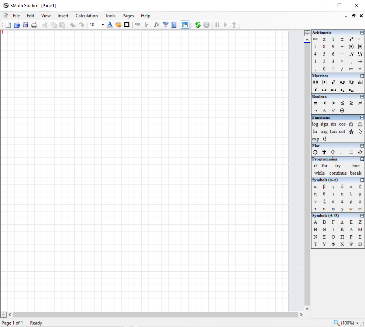

I don't know what is happening but it seems image plugin is ruining the integrity of Smath Studio
I am using Nvidia GTX 1070 with 2560x1440 resolution and 125% text on Windows 10 if it will helps.
Without Plugin everything seems normal,

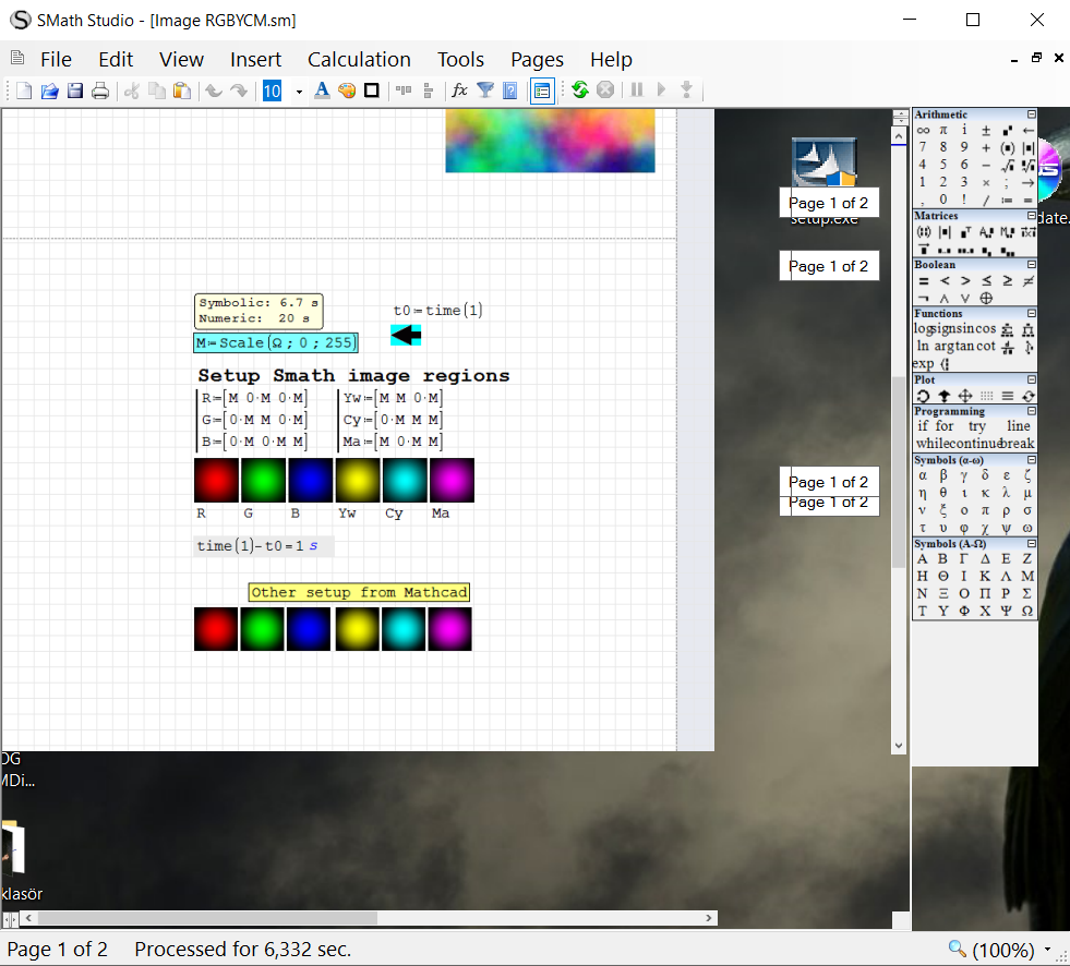

When I install the plugin the Smath Studio got crazy.
#110 Posted: 2/20/2017 7:34:42 PM
If you get the last R,G,B,Yw,Cy,Ma => the image region is OK.
This is 6179 on Win 7 ... please report for further insight.

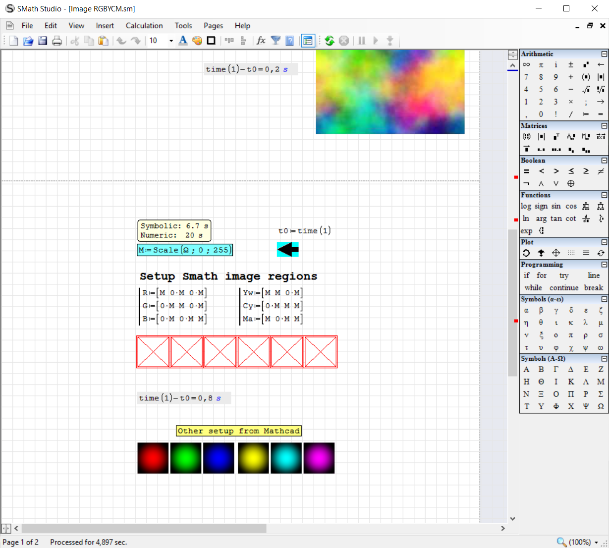

Image RGBYCM.sm (292.27 KiB) downloaded 1629 time(s).
#113 Posted: 2/22/2017 7:15:02 PM
598 likes in 1,380 posts.
That is not resolution, it is the "pixel display".
PC screen have 96 ppi resolution [ppi = pixel per inch]
I know you just love to correct people but according to wikipedia your statement is wrong. 2560x1440 is a resoulution and called WQHD.
https://en.wikipedia.org/wiki/Graphics_display_resolution
I have never said image region is not working, it just scrambles the Smath (6179) window with my Windows 10 display settings.
You can see that on the screenshot below too. Everything is fine if I remove Image Region.

Issues are are form's fonts changed, desktop background visible through the window and these. I'll see if I can help Alex, as pointed out the issues are related to windows 10 only.
