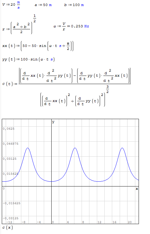

Hello everyone!
I have difficulty plotting the function c which depends on the derivatives of two functions which in turn depend on the parameter t.
Could anyone help me? This in the smath file.. curvatura.sm (11.36 KiB) downloaded 1080 time(s).
Thank you so much

Hello everyone!
I have difficulty plotting the function c which depends on the derivatives of two functions which in turn depend on the parameter t...
Maybe this is what you want...
... and the .sm file: curvatura1.sm (9.4 KiB) downloaded 1138 time(s).

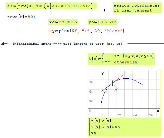

But I need more help.
How can I draw the tangent line to the equation in parametric form?
this is the file … curvatura2.sm (12.5 KiB) downloaded 1187 time(s).
#7 Posted: 12/6/2019 12:48:15 PM
1,081 likes in 1,754 posts.
Hi Ale. Here, some ways.
curvatura3.sm (25.1 KiB) downloaded 1149 time(s).

#8 Posted: 12/6/2019 1:08:58 PM
Thank you very much for the availability.
For the Tangent over C(t), it will follow the scalar rules
of the document Tangent.sm posted before.
The Tangent over the parabola is another business.
Smath does not derive linterp(x) as it is NOT a function
only an interpolation. This project and lot more are
rescued via Infinitesimal Analysis [dates back before CAS].
For that particular typical user point of tangency, OK.
You may want to experiment more .
Don't mind to see noisy curvature [disabled in collapsed].
Chers ... Jean.
curvatura2 Copy.sm (30.56 KiB) downloaded 1123 time(s).

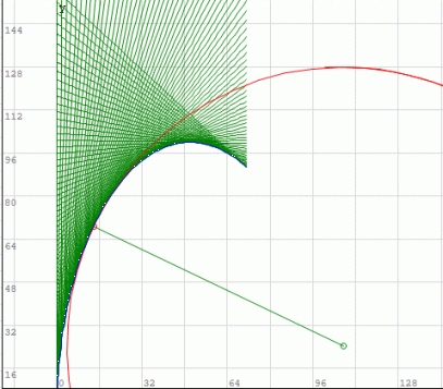

#10 Posted: 12/6/2019 2:05:01 PM
Thanks for the answers.
But if I wanted to find the tangent to the curve when the parameter t changes, how should I do?
Do you mean the envelope, all the tangents for the range en T?
curvatura5 - envelope.sm (23.64 KiB) downloaded 1038 time(s).
Best regars.
sergio 12/6/2019 5:19:00 PM

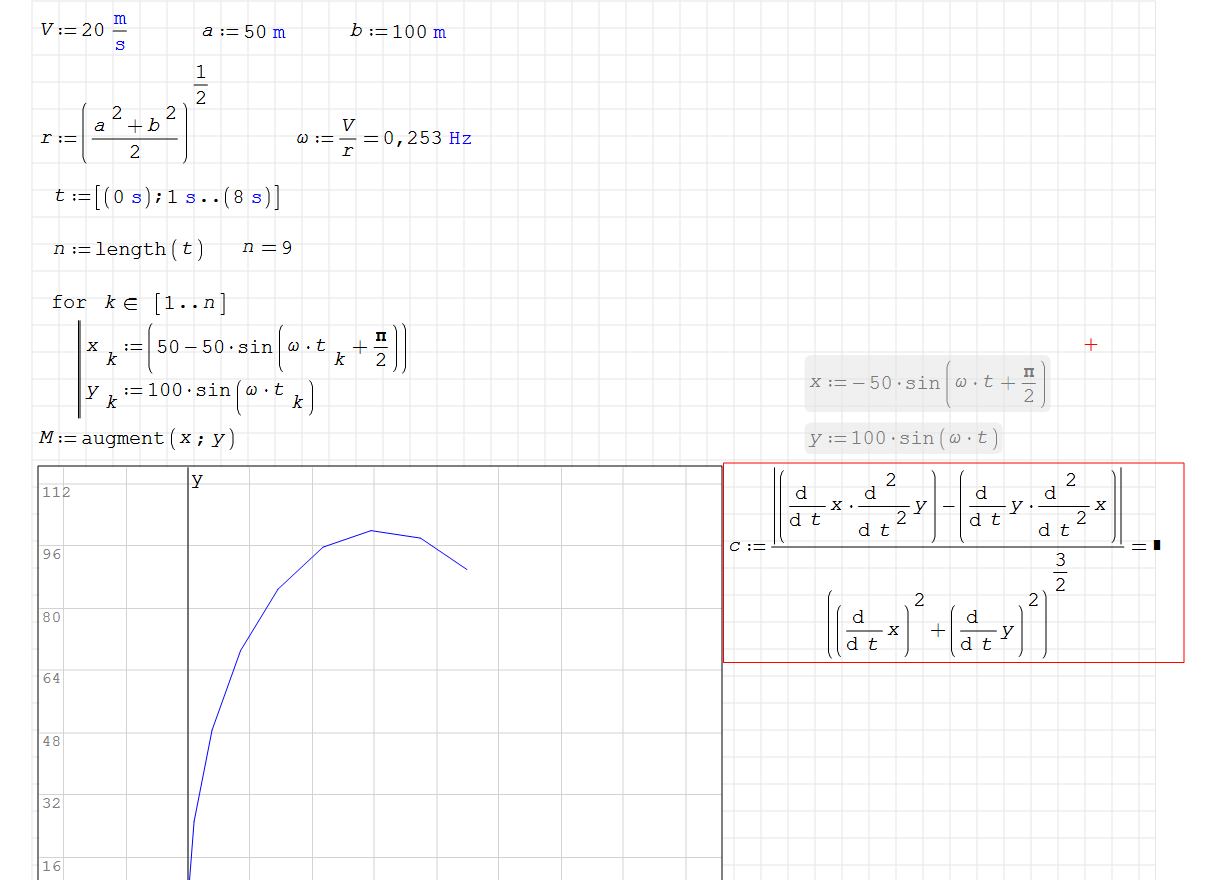

#13 Posted: 12/6/2019 10:48:04 PM
Your project has been refactored strictly on discrete.
OK, you have functions but life is from collected data.
Collected data are always noisy from the quantization,
a small amount of Gaussian Ksmooth is often sufficient.
Ksmooth being applied before cinterp
As exemplified, cinterp is the best interpolator for
a clean curvature plot from infinitesimal maths.
I don't understand what your were attempting c(t) last module.
Please, don't hesitate for more.
Maths Tangent Data Set Copy.sm (36.61 KiB) downloaded 1090 time(s).

#14 Posted: 12/6/2019 11:22:41 PM
O
.... more maths are coming:
cumulative integration, arc length
derivative you already have it from last attachment.
