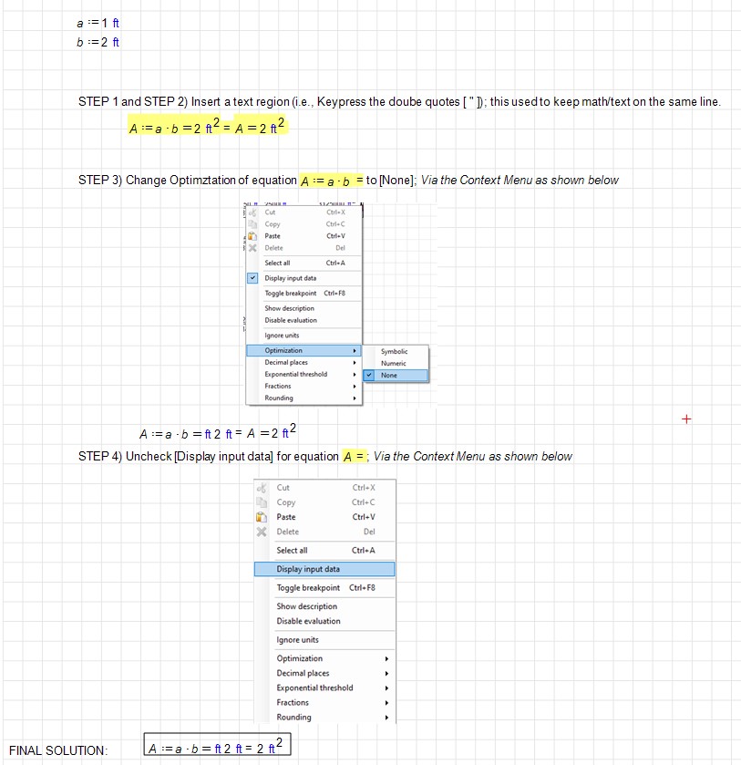

#2 Posted: 6/28/2022 5:05:29 PM
Greetings!
This is possible, but there is some work involved to make it happen. After you define your variables a and b, do the following:
STEP 1) Insert a text region (i.e., Keypress the double quotes [ " ]); this used to keep math/text on the same line.
STEP 2) Type your equation 「A:a*b=#」, the text 「 = 」, and the equation 「A=#」 into your text region.
STEP 3) Right-click your 1st Equation, on your context menu you will see [Optimization]; change this option to [None]
STEP 4) Right-Click your 2nd Equation, on your context menu: uncheck the [Display input data] option.
NOTES: With units, it will simplify 「1*m」 to 「m」; so this isn't a perfect solution by any means.
Example:
Here is a file with an example: SMath - substituting variables into same equation.sm (46.02 KiB) downloaded 1333 time(s).
Hope this helps!

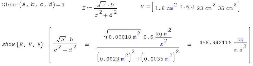

Hi. It would be great to have a new equals sign, such as ≡ , that shows the substitution of an expression for its values, but without the rounding problems that this proposed solution has, and showing the final result in Pascals, perhaps.
