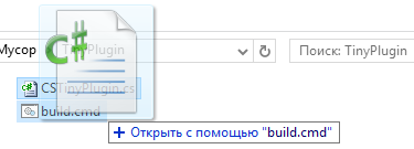

For c#:
1. Create file build.cmd
Show Spoiler
2. Create source file CSTinyPlugin.cs
Show Spoiler
3. Build assembly using command: build CSTinyPlugin.cs
Also you can use drag and drop technique for this.

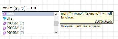

You get CSTinyPlugin.dll
5. Copy CSTinyPlugin.dll to the C:\Program Files (x86)\SMath Studio\plugins folder and restart the program.
6. Test it.

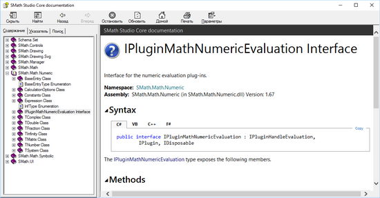

7. Read the SMath Studio Core documentation: SSCoreDoc.chm.

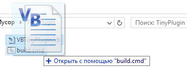

3. Build assembly using command: build VBTinyPlugin.vb
You get VBTinyPlugin.dll

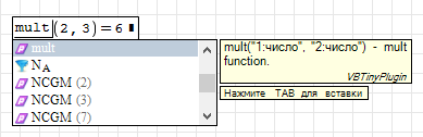

5. Copy VBTinyPlugin.dll to the C:\Program Files (x86)\SMath Studio\plugins folder and restart the program.
6. Test it.
