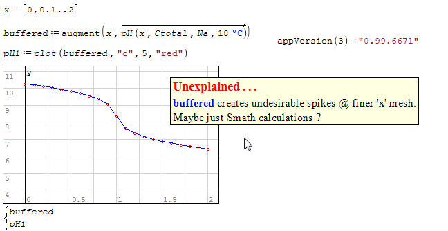

#2 Posted: 7/10/2018 11:36:55 PM
Works fine.
... refreshed, optimized calculation timing
Added the buffered plot to be splined for + values.
Inst_pH Solution.sm (44.9 KiB) downloaded 1177 time(s)....refreshed/augmented

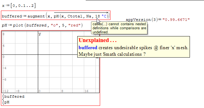

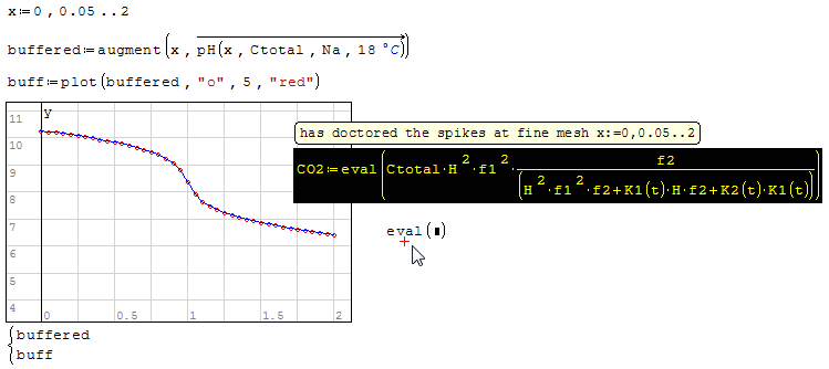

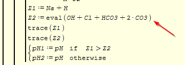

#3 Posted: 7/11/2018 4:42:18 AM
Hello Jean,
For me, the first plot is working
but the second is not - cases() is complaining.
I could see that sigma2 went nuts (do not know why) and put eval() in front of it
I do not have the explanation of this - might be a bug.
#4 Posted: 7/11/2018 8:09:43 AM
1. Can't understand the error cases(,) [6671]
2. Make unit K was first problem , done well.
3. Doctoring for the spikes works and accelerates calculation timing.
Inst_pH Solution Copy.sm (46.65 KiB) downloaded 1196 time(s).

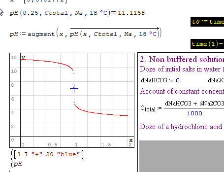

Can you explain sheet. I was looking at creating a Langelier Saturation Index (LSI) for quick analysis and this appears to be going in that direction
#6 Posted: 7/11/2018 11:16:55 PM
Can you explain sheet.I was looking at creating a Langelier Saturation Index (LSI) for quick analysis and this appears to be going in that direction
The program is a dual iterative solver.
Give some more about Langelier saturation index.
#7 Posted: 7/11/2018 11:49:28 PM
Langelier saturation index [LI] has nothing to do wrt unbuffered.
As it looks, there are lot of those things already tabulated.
Wait and see if you can come up with some interesting stuff.
