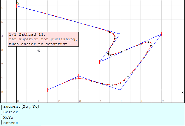

#11 Posted: 10/26/2017 9:47:29 AM
983 likes in 6866 posts.
Thank you.I'm going to continue to monitor for a bit more.From what I have read from this forum it seems like it's a pretty decent.I'm going to download probably tonight and install and put it to some use.I'm ok with it not being a clone and again my needs aren't super high end.As long as its fairly usable and does what I need it to do I think it will be a good fit.
My friend, you will drop dead what Smath can do for you !
Further, Smath Community is very friendly and helpful.
Bad luck: PTC couldn't renew Maple contract. Smath/Maple companions
is the all thing for advanced Engineering/Scientific applications.
Smath is superb for publishing projects. In many respects, easier
to work with than Mathcad was [11 and earlier].

#12 Posted: 10/26/2017 10:52:56 AM
... Mathcad 11 can't do the very same, superb for publishing.
#13 Posted: 10/26/2017 11:13:19 AM
... from Smath/Maple companions
