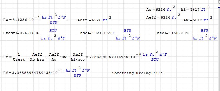

Hi
I always thank you for your efforts to improve the SMath.
I think that I found a bug of SMath calculation.
Please, check it.
Thank you!
Bug report.sm (9.79 KiB) downloaded 1217 time(s).
Please, check it.
Thank you!

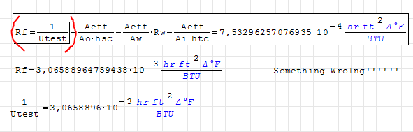

Seems you defined Rf as 1/Utest (definition in a placeholder)
![2016-09-28 09_35_56-SMath Studio Desktop - [Bug%20report.sm].png](/en-US/files/Download/rxvzMn/2016-09-28-09_35_56-SMath-Studio-Desktop---[Bug%20report.sm].png)
![2016-09-28 09_37_48-SMath Studio Desktop - [Bug%20report.sm].png](/en-US/files/Download/Vhkaux/2016-09-28-09_37_48-SMath-Studio-Desktop---[Bug%20report.sm].png)
In latest RC if you try to edit the formula (f.e. removing the unit from the result), the auto correction applies the parenthesis showing the error

Original expression: the expected value is shown but not assigned to Rf. Rf just gets the first term, as the scope of the assignment operator is limited to the term 1/Utest. The remaining terms just change the displayed value but not the storage for Rf.
Rf:1/Utest-Aeff/{Ao*hsc}-Aeff/Aw*Rw-Aeff/{Ai*htc}=7.53296257076935*10^{-4}@{'hr*'ft^2*'Δ°F}/'BTU
Expression with parens, the displayed value is the same as before but now coincides with the value assigned to Rf
Rf: (1/Utest-Aeff/{Ao*hsc}-Aeff/Aw*Rw-Aeff/{Ai*htc})=7.53296257076931*10^{-4}@{'hr*'ft^2*'Δ°F}/'BTU
Expression as before, but with the outer parens deleted. There is no difference to the original expression in the serial representation from the clipboard, still the whole expression is assigned to Rf.
Rf:1/Utest-Aeff/{Ao*hsc}-Aeff/Aw*Rw-Aeff/{Ai*htc}=7.53296257076931*10^{-4}@{'hr*'ft^2*'Δ°F}/'BTU
The differences between first and third expressions are visible in the file (stack based UPN-like format) and this is obviously also the base of the actual calculation.
