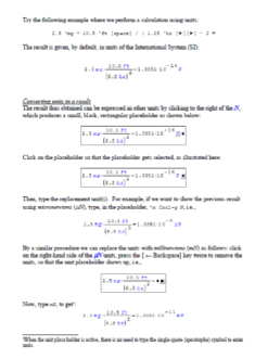

I have unis for example:
a=2MPa
b=2N/mm2
a+b=4*10e6 Pa
How can I obtain the answer in N/mm2, not in Pa. Is it possible. In Mathcad simple change the units, but it's a pity here it doesn't work. Thank You for reponse. Paulius

Nmm²:=1 ....... a:= 2, b:=2 .... a+b=4Nmm²

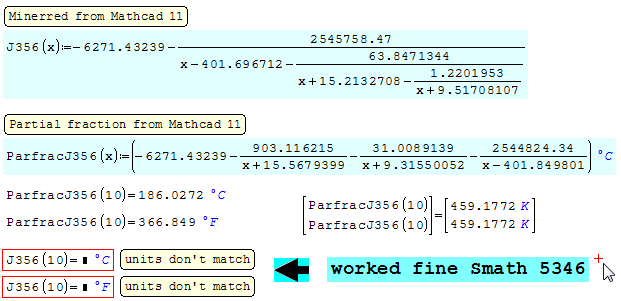

On the other hand, Smath unit system has changed from Smath 5346 to
Smath 6179 ... that freaks many of my projects.
