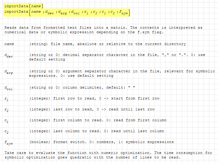

is it possible to import a file in txt to the smath and organize it by columns and rows???
#2 Posted: 6/17/2021 1:49:55 PM
598 likes in 1,380 posts.
If you mean a comma separated file (csv), yes it is possible with importData().

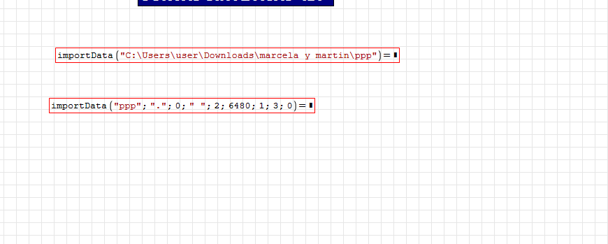

#3 Posted: 6/17/2021 3:39:09 PM
mnorena
mnorena
0 likes in 13 posts.
I allow your instrruccions, i dont know if i am doing ok, the name of the file is "ppp" and it shows me in the smath studio thats it is not reconized.

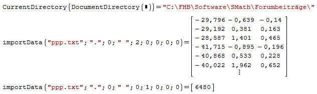

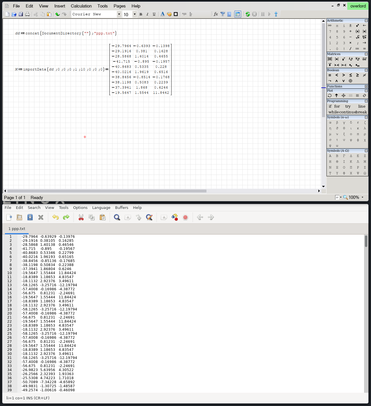

#7 Posted: 6/17/2021 5:12:18 PM
You can access differently formatted sections by reading them separately.
import.sm (4.81 KiB) downloaded 1159 time(s).
