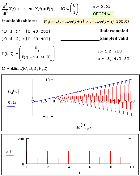

Simple test 2.
DotNumerics.ode.test2.sm (21.23 KiB) downloaded 1672 time(s).
DotNumerics.ode.test2.pdf (79.99 KiB) downloaded 805 time(s).
sergio 8/1/2018 6:06:00 PM, Radovan Omorjan 8/2/2018 3:05:00 AM

Simple test 2.
Works nice conventional/visual [6179].
That document, if it would come from other designer
would pass my QA [Quality Assurance].
DotNumerics.ode.test2.sm (24.51 KiB) downloaded 1762 time(s).

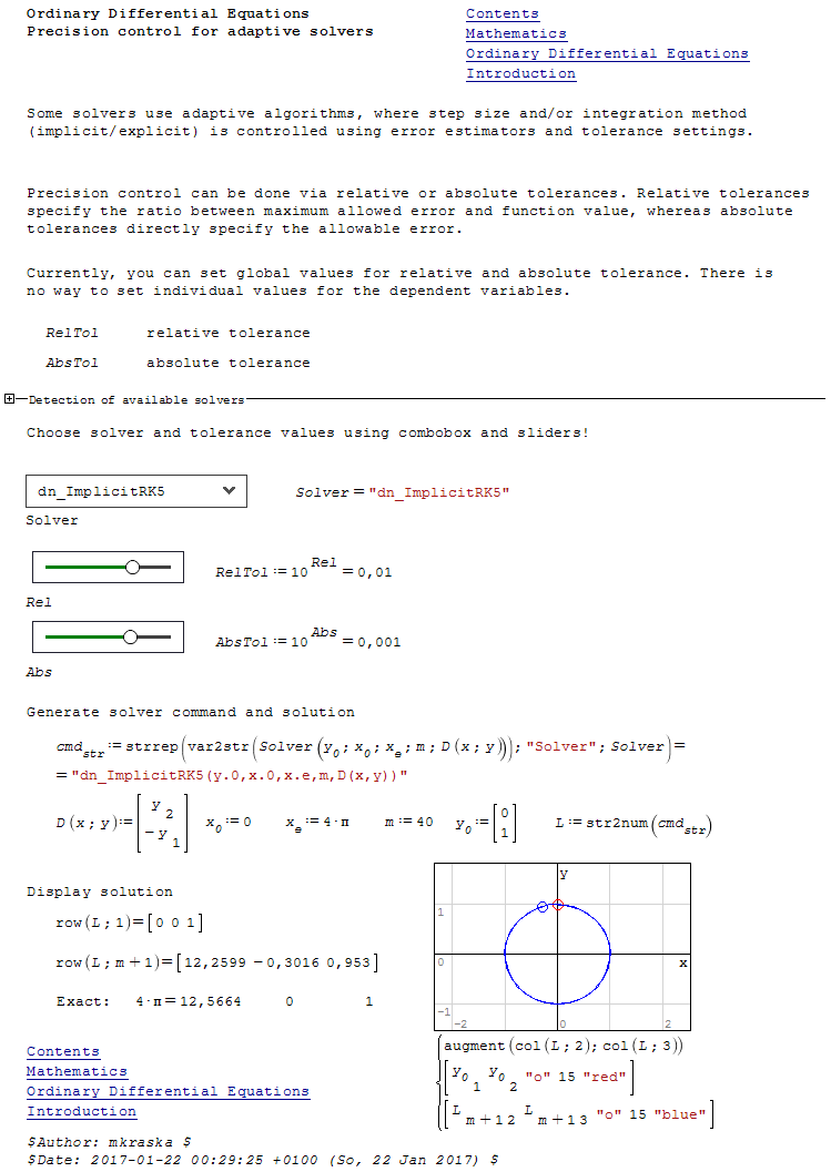

It seems that all the dotnumeric ode solver functions fail to add the last step to the solution. In the given example, the exact solution is (approximately) met if the end value of x is increased by one step (x_end/steps).
The sheet is easily extended to whatever ode solvers by adding their name to the search list. The actually available solvers depend on what plugins are installed.
Section Math ODE precision.sm (23.66 KiB) downloaded 1818 time(s).
frapuano 9/9/2018 5:18:00 PM, Вячеслав Мезенцев 9/10/2018 5:37:00 AM

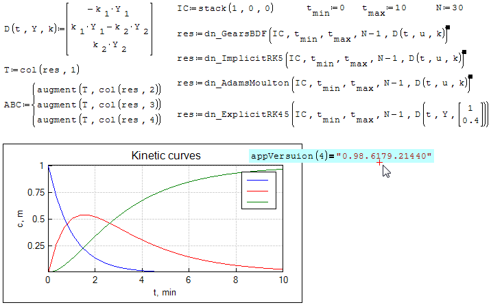

Updated.
2018-12-24_17-06-48.png 2018-12-25_04-33-23.png 2018-12-25_04-34-24.png dn.ode.test2.png dn.ode.test1.png 2018-12-24_17-07-41.png
dn.ode.kinetic1.sm (8.26 KiB) downloaded 1915 time(s).
dn.ode.kinetic2.sm (12.59 KiB) downloaded 1792 time(s).
dn.ode.kinetic3.sm (12.28 KiB) downloaded 1842 time(s).
dn.ode.test1.sm (19.58 KiB) downloaded 1860 time(s).
dn.ode.test2.sm (18.88 KiB) downloaded 1834 time(s).
dn.ode.Amplitude detector.sm (20.17 KiB) downloaded 1887 time(s).
dn.ode.kinetic1.pdf (77.42 KiB) downloaded 1042 time(s).
dn.ode.kinetic2.pdf (93.05 KiB) downloaded 979 time(s).
dn.ode.kinetic3.pdf (91.31 KiB) downloaded 963 time(s).
dn.ode.test1.pdf (115.72 KiB) downloaded 941 time(s).
dn.ode.test2.pdf (120.44 KiB) downloaded 932 time(s).
dn.ode.Amplitude detector.pdf (148.87 KiB) downloaded 986 time(s).
4 users liked this post
NDTM Amarasekera 12/24/2018 9:44:00 AM, sergio 12/24/2018 11:04:00 AM, frapuano 12/24/2018 2:23:00 PM, Radovan Omorjan 12/24/2018 2:52:00 PM
