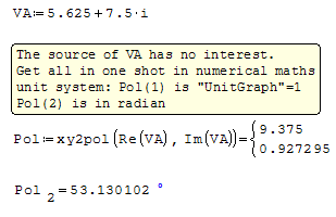

#4 Posted: 6/5/2016 3:14:46 PM
Better be in harmony wth the maths and Smath.
There is nothing to look gain, Smath is OK.
The Magnitude (length) and The Angle (angle) in polar coordinates have different units.
For sure they have different units: one is in "UnitGraph" the other is in "rad"
The rad is not a common unit. It is not correct.
YES: rad is correct, rad is the maths unit in trig approximations as well as in official tables.
If you want °: convert by appending ° in the Smath result

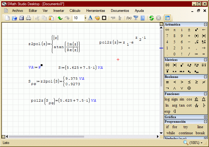

#9 Posted: 6/5/2016 7:55:50 PM
WroteMike,
The xy2pol does not work when units are included:
Do we agree?
Yes we do
QuoteWhen eventually it is working:
The units of the "Magnitude" and the units of the angle, (for the case of complex numbers here), will be different.
Yes, that's what I show in my screenshot, that uses ≡ instead of =, just to show the desired result: seeing is better than reading.
QuoteNote: I see you got W(att) how?
Now I suppose it's apparent: Ctrl+= and manually make system with desired result
QuoteI see that you have a semicolon ( ; ) I have a comma (,).
Re(S);Im(S) versus Re(S),Im(S)
Russian locale default settings
С уважением,
Михаил Каганский
#10 Posted: 6/5/2016 7:57:34 PM
In this specific set of applications I have no interest in "numerical MathEMATICS". [Basile]
From A...Z, Smath is a numerical math tool as any other CAS and including your specific application.
xy2pol result is a vector of two components that need no unit as they are implicit. Extract each
component and append a dead unit decoration for clarity to yourself and the reader.

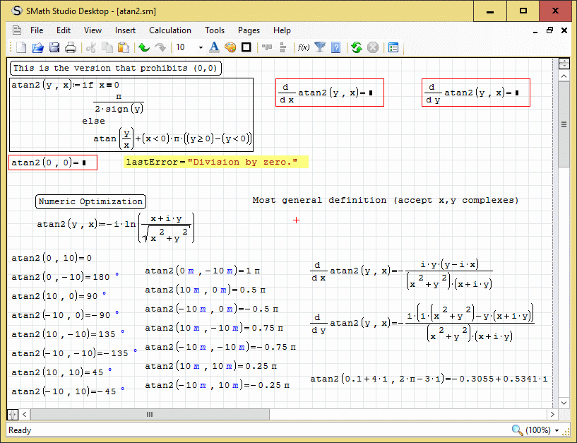

WroteNotice that atan2 ins't in SMath, which is more correct than atan for this functions (see http://www.mathworks.com/help/matlab/ref/atan2.html for example).
atan2.sm (35.42 KiB) downloaded 1216 time(s).

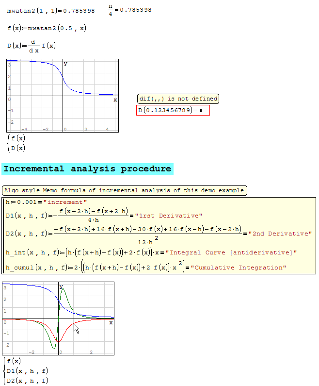

#12 Posted: 6/5/2016 8:58:58 PM
Hi Mike. I prefer this other, but have some round inconvenients:
#13 Posted: 6/5/2016 9:04:35 PM
WroteI guess that with the new try function samebody can make a good one atan2.
But with try, it won't differentiate again.

#14 Posted: 6/5/2016 9:10:02 PM
WroteWroteI guess that with the new try function samebody can make a good one atan2.
Oh, I think that this happen only to me :-). Not very sure that try don't accept diff.
So, this with numerical optimization must to be the best solution (until atan2 not be in SMath):
#15 Posted: 6/5/2016 9:24:33 PM
It's a good option, and only ~30% slower.

#16 Posted: 6/6/2016 10:11:40 AM
Like this Alvaro: look for the Matlb code in the f(x) menu,
look for mwatan2 ... if you have in your version: then go
Maths atan2.sm (10.93 KiB) downloaded 1252 time(s).
