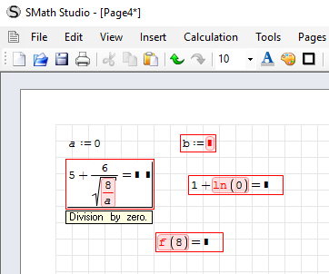

  • Part of the equation which causes an error is highlighted now;

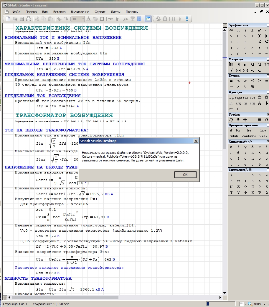

при єкспорте в формат odt выдает ошибку

I'm unable to reproduce. Can you attach the file that cannot be saved as odt?

I tried SS 0.99.6962 and 0.99.6970 with different localization options and I can save without errors. Please post even the error message when you can (with the stack trace, if any). Anyone else notice issues?

It is possible that you don't have .NET 2.0/3.5 installed or enabled on your system (System.Web isn't available in .NET framework 4+ AFAIK). Please download the development tools plugin and then from "Insert > Development tools > System informations" paste the data here.
Нужно указать больше информации об окружении: версия Windows, версия SMath Studio (+разрядность), версия используемого плагина (Data Exchange). Трудно без этой информации воспроизвести и решить проблему. Мне тоже не удалось её повторить.
Windows 7
SMath Studio Desktop 64 бит. ver. 0.99 сборка 6977
Data Exchange 1.1.6858.3747
NET framework 4 is installed on the system

In mine too; but what about previous versions?
CLR 4.0.30319.42000
	installed versions:
	v2.0.50727	2.0.50727.4927 SP2
	v3.0	3.0.30729.4926 SP2
	v3.5	3.5.30729.4926 SP1
	v4
		Client	4.7.03056
		Full	4.7.03056
	v4.0
		Client	4.0.0.0
