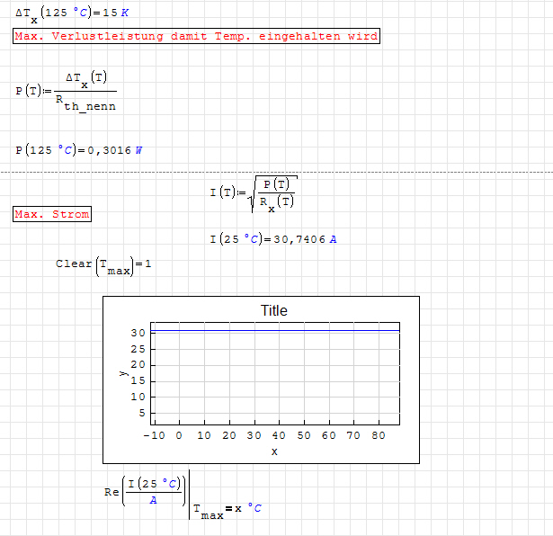

Hey guys,
since I´m using SMath instead of Exel sheets, my calculations are a lot easier, thanks!
But currently, I have a problem, where I was unable to find a solution.
Is it only possible, to plot ONE function?
I want to do plot a diagram where the variable (x-axis) is at the beginning of the sheet(e.g."z"). It influences the whole calculation over 2 pages. It's to much, to get in in one formula.
It is possible to plot a diagram of the "last" formula (e.g. "f()") in dependence on a variable "in the beginning"
(=> f(z), where z is not in f(), but in a previous formula of which f() is dependent.)
Hope someone is able to answer my question.
regards
freakyuser

I attached the file. I want to make a plot/diagramm how e.g. T_max changes the solution.
Drossel_berechnung.sm (26.66 KiB) downloaded 1333 time(s).

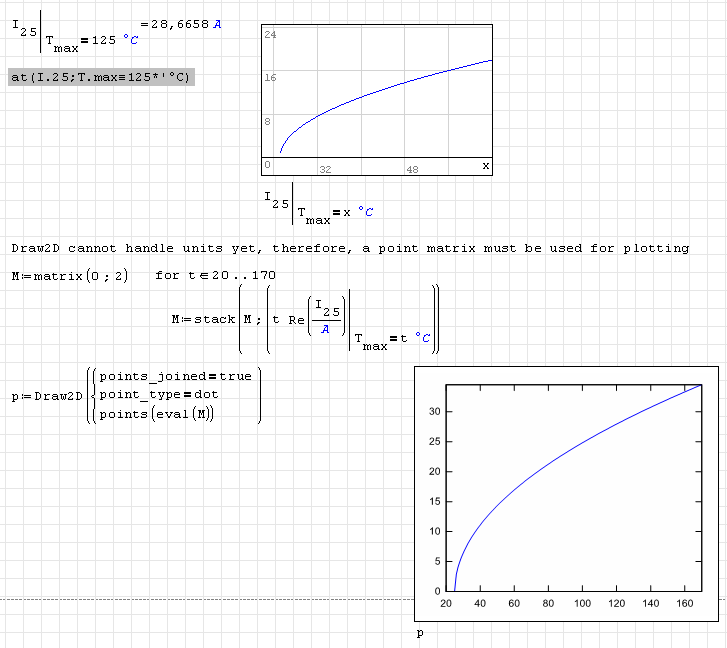

Normally, you would keep the parameters which are subject to later change as function arguments in the definitions. E.g. all quantities should be defined as function of T.max.
However, given the sheet as it is, the simplest way is to switch off the numeric parameter specifications. That enforces SMath to store the symbolic formula and you can afterwards apply the substitution operator (at() function).
Drawback is that you do not get numeric results unless you either provide global values by just defining them in the sheet (can be done below all other definitions) or by specifying local values using at().

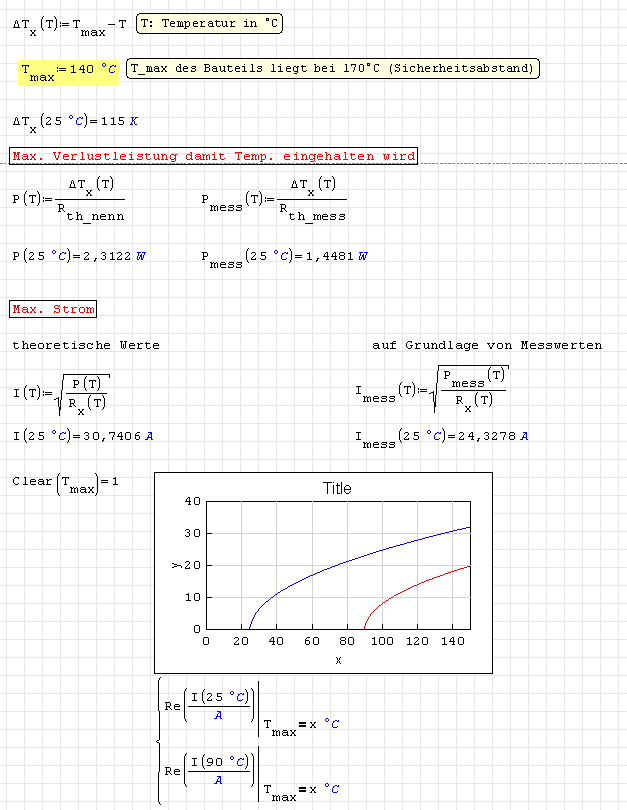

I tried to do this already before asking, but wasn´t very successful... Well, I attached my "Test file" also.
Thanks, I was able to reproduce it, but the reason why I use SMath, the "documentation" like calculation gets lost.
How should I design my calculations, to use the diagrams and keep the numeric results? (Maybe a short example )
Thanks for your help and work for this great tool.
Drossel_berechnung_test.sm (28.42 KiB) downloaded 1307 time(s).

It is essential that DeltaT.x is stored as symbolic definition with T.max not replaced by a value.
Downstream the sheet you can give it a value for displaying results.
For plots, you have to clear the value and use the substitution operator. Alternatively, you could define DeltaT.x as a function of T and T.max in the argument list and do as well for all other defintions. Then you just could call I(25°C, x°C) instead of using at().

This is something I tried to do, but when there are more than 3 variables it becomes rapidly confusing.
So I think the at() function is the better way.
I tried to use it just like you did, but the value doesn't change.
I changed the formulas to symbolic.
Whats the issue?
Thanks for your help and time.

As I said, the definition of T.max must be after the definition of DeltaT.x, otherwise the numeric value is stored in the definition instead of the symbol. Hover with the mouse over the definition of DeltaT.x in order to see what is actually stored.

But it only works, when I write T.max under the definition of I(T), otherwise I(T) is stored also numerical and not symbolical.
The other way is, to clear T.max before every definition and define it again afterwards.
Is this the only possible way, or do I something wrong?
Drossel_berechnung_test_v2.sm (334.43 KiB) downloaded 1354 time(s).
