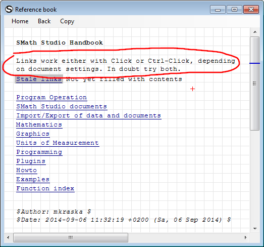

I think that your problem was that in tha Martin's Handbook you have to pres CTRL+Left mouse click and in the Reference book made by Andrey (goes with SMath) it is enough Left mouse click to open other worksheets. Actually, I think there is still no simple way to make these Handbooks like Andrey did.
Martin Kraska 11/29/2017 4:54:00 AM
#6 Posted: 11/29/2017 4:53:31 AM
1226 likes in 2153 posts.
Radovan, thanks for pointing this out. I had forgotten about this. The behaviour of the links depends on the read-only status of the handbook files, at least this was so some years ago. I considered the handbook browser being just a workaround for a real help system. But as you see, workarounds can last for long time.
If that is really the source of the problems reported above, I see two options to avoid it:
- I could write a script to set all files read-only and then test if this leads to functional restrictions of the handbook pages.
- The user could care the instructions on the main handbook page.
