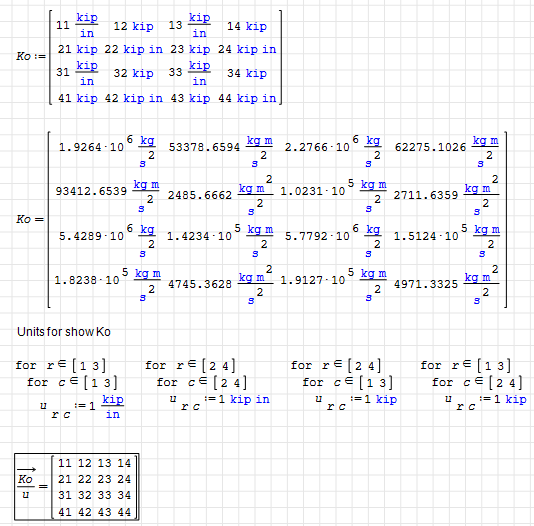

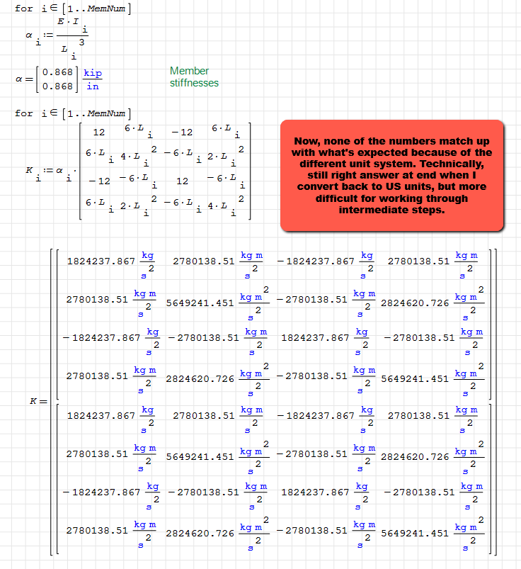

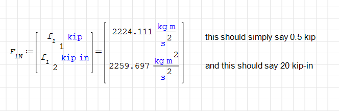

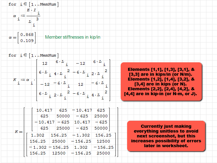

I've been using SMath for several years now, and I generally like it. But one shortcoming compared to Mathcad has always been the units for the US, even though consistent and automatic unit conversion is SMath's most helpful ability compared to something like Excel for engineering calcs. Most of the time, I can just go through the extra steps of typing in the units I actually want every time SMath displays the results in metric units. But I can't do that in matrices. If everything in the matrix is the same unit, then I can type in my USCS units outside the matrix and everythign is good. But sometimes I have mixed units like with stiffness matrices, and I end up with results like below with no way to force them to display correctly. Even these are the result of an extensive workaround earlier in the worksheet where I basically made all my inputs dimensionless and had to keep track of units manually, as some of my stiffness matrices will have various elements in kips, kips/in, and kip-inches, all in the same matrix and not segregated by row or column. I've tried using the "Imperial" option in the user settings file several times over the years, but that is worse than leaving it metric and manually changing every unit in every formula. I've tried editing the Units.xml file, but I'm not sure how to go about that. Is there any guidance on how to edit that? Long story short, I would really request a better ability to define default units, especially when dealing with matrices. They need to be able to have certain units on a per-element basis.

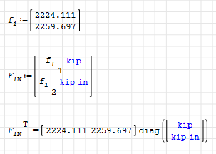

... If everything in the matrix is the same unit, then I can type in my USCS units outside the matrix and everythign is good. But sometimes I have mixed units ...
Hi Jason. This is a workaround. You can't show a column vector with mixed units, but a row vector.
row_vec_mixed_units.sm (3.77 KiB) downloaded 1710 time(s).
Oscar Campo 10/31/2022 12:10:00 AM, sergio 10/31/2022 5:31:00 AM

#5 Posted: 10/31/2022 1:04:03 PM
Hi Jason. This is a workaround for show mixed units in a matrix.
matrix_mixed_units.sm (18.34 KiB) downloaded 1705 time(s).
Oscar Campo 10/31/2022 1:22:00 PM, sergio 10/31/2022 2:23:00 PM

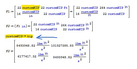

One thing you could try is to construct your matrix with pseudo units (that is, use a "unit" that is not defined, before your matrix for ease of reviewing. Just remember to define your "unit" afterwards to make the math work out). Below is an example, I create a matrix with the unit of 'customKIP. I multiply that matrix by inches (see variable F2) and display the result. After that, I define 'customKIP:='kip and the math now works out:
Hope this helps!

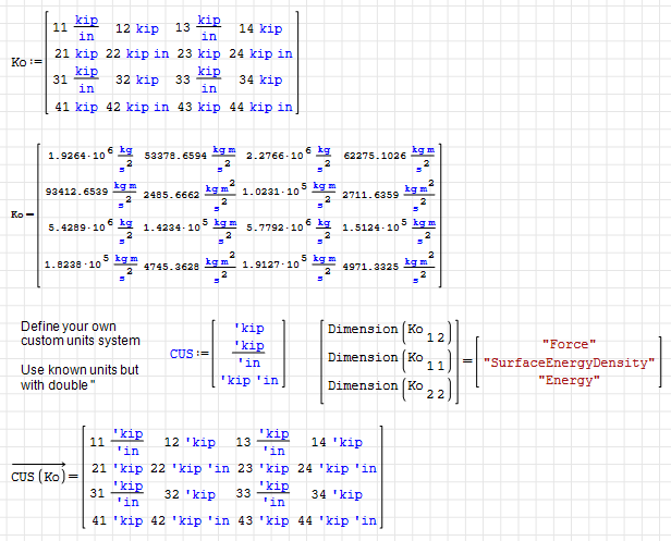

#7 Posted: 10/31/2022 6:59:08 PM
Another way (always there is one more). Using Dimension utility, from this post.
dimensions v2.sm (68.59 KiB) downloaded 1681 time(s).

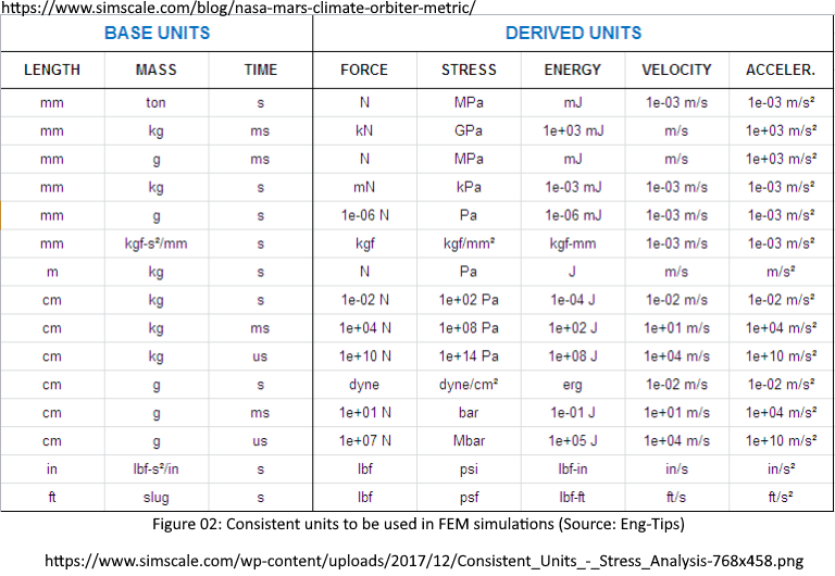

#14 Posted: 12/28/2022 2:58:10 PM
How NASA lost a 327 Million Dollar Mission to Mars: https://everydayastronau...om/mars-climate-orbiter/
IMHO, NASA has no QA [Quality Assurance Department].

...But sometimes I have mixed units like with stiffness matrices, and I end up with results like below with no way to force them to display correctly...
Notice that Jason does not want kg to be replaced with lbm , nor does he want m to be replaced with ft, but rather to have 2224.111 ㎏ ㎨ reported as 0.5 kip. From a metric standpoint, I would presume the result of 2.22 kN would be preferred.

  • utilize custom units
    • PRO:
      • results of force will not report values in terms of seconds
      • easier to preform quality control
    • CON:
      • requires more setup
      • inability to force units to simplify (e.g., ㎏*㎨ --> kN)
      • custom units will be at odds with built-in units (i.e., 'inches ≠ in )

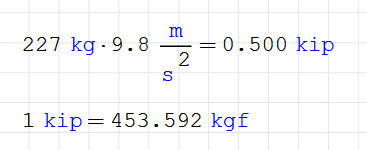

    #18 Posted: 12/29/2022 1:37:03 AM
    Mark R Harris
    Mark R Harris
    4 likes in 90 posts.
    Quote
    Notice that Jason does not want ... but rather to have 2224.111N reported as 0.5 kip.
    Sorry Kenny & Jason, I suspect that I'm not understanding this issue fully. SMath appears to be handling the conversions and units display correctly:
