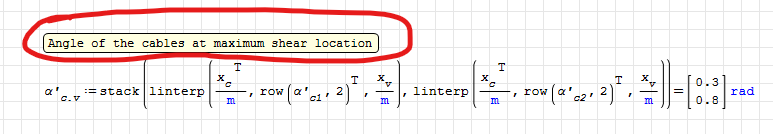

It would be good if SMath offered the functionality of formatting the description region, including: (i) font, (ii) background (yellow is cool, but not always applicable), (iii) frame/boundary (on/off).

You lost me there. Are you saying it is possible to change the colour of description background (see below) from the default yellow?

Thanks Jean. I think we misunderstood each other. I was proposing to change the background of the description region/field, rather than the input region, as your example shows. Something like this:
This is not possible.
In fact, I asked for this 10 years ago.
Alteration of descriptions not implemented since.
Text regions doesn't have description too.
Asked for this also, no change so far.
Long word short, don't rise your expectations.

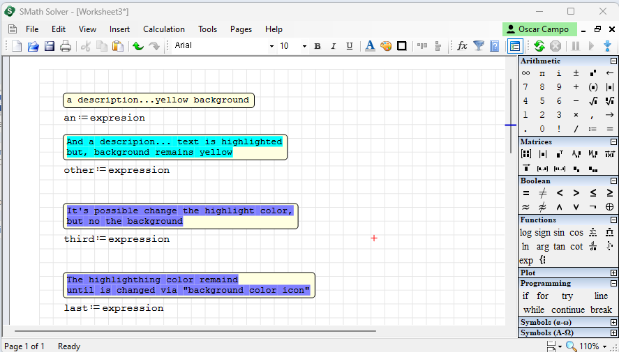

It's not possible change the background color of description region.
Only it's possible change the color which the text is highlighted inside a description region.
Please see this video:
best,
Oscar
This is not persistent. Possibly just a visual bug.
Background color changes to description text is not saved.
I checked with an external text editor, no data saved related to it.
They are same with yellow background and colorful highlighted.
When you save file, close it and reopen it all colors will revert.
Either to latest selected background or yellow.

It is a very strange behavior...
But, before I posted, I did that check you mention. I saved the file, then closed SMath, reopened, and the colors remain...
#14 Posted: 9/20/2023 11:23:01 AM
598 likes in 1,380 posts.
Close smath, reopen with a blank page, change background color to white, close file without saving.
Now reopen smath with the file you saved, background highlight should be gone.
Oscar Campo 9/20/2023 11:37:00 AM
#15 Posted: 9/20/2023 11:37:53 AM
Oscar Campo
Oscar Campo
135 likes in 309 posts.
Yep..
you're right...
it's only a bug
Thanks!!

Previusly reported here. No change in the background of description region, only the text is highlighted, but is not permanent, was checked as a bug here

Not a bug, just a fact Smath does not save this Windows facility.
Smath saves itself only, thus not Windows background.
All that said, simply a local convenience.
However, superb for publishing *.PDF document.
