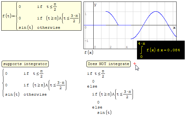

If(a,b,c) <= cases
If(a,b,c) <= cases - If(a,b,c) <= cases - Messages
#1 Posted: 3/5/2018 2:42:41 PM
983 likes in 6866 posts.
Convenient inside program [Exemplified in the attached].
Does NOT support "break" statement.
